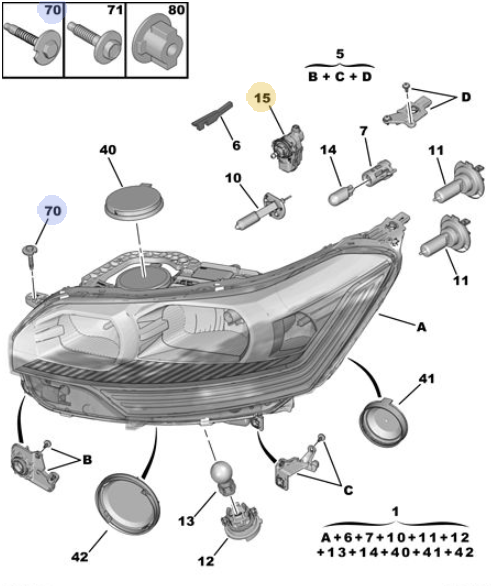

Below from another post Marc, sounds like the offending item... I can stop the noise if I wiggle harness?? but battery not even connected to car! are there Vac pipes going into it?
The Headlamp beam correction unit is either under the left hand light unit or under the battery housing (depending on engine).

Re: noise from front Passenger side / failing GPS aerial
Hi John - no, not an annual fee - Donor status remains, but is for up to 2 years.
This is the location, item (15).
I've put up the removal refitting guide for the headlamp correction unit in the Member's resources section, link below:
