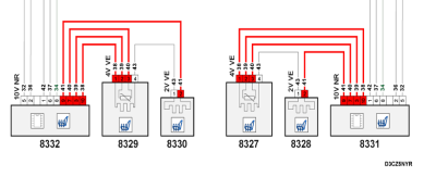

Looking at the diagrams would i be correct in thinking that i could actually remove the plugs from 7,8,9 and 10 and plug the whole assembly into the opposite seat wiring for test purposes?
I was just thinking that maybe item 7 could be an issue and rather than swap just the heated seat switch i should just swap the lot over to see if i get the same issues on the passenger seat which i know is working correctly ?
Colin
x 6946
Re: C4 2010 heated seat question
Hi Colin. no that won't work as although the heated seats have identical connectors, the heated seat control units have different pin-outs, so you could damage the circuit. I've highlighted some of these and you can see the pin numbers are in different positions.

Am i missing something or are they not both the same pinouts??
The schematic diagrams dont show true pin positioning, only how the wires connect, they move the positioning about on the diagrams to make the diagrams easier to read so there are not too many wires crossing over each other.
x 6946
Of course, I must of lost the plot on this one! Oops :oops:
At least that will test the connector blocks / switch units / rheostats - or show a wiring fault if the swap fails to work Colin.

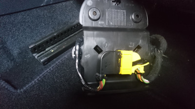

I have managed to remove the side panel but i only have the 3 plugs for lumbar/ massage / heat buttons, i do not have item 7 which looking back at the images that would appear to be for fully electric adjustment ?
So what i have managed to do is swap the heat switch for the passenger side one and the old one does work correctly in the passenger side :(
The drivers side switch does light up and stay lit once the engine is running only if set to zero, as soon as the dial is turned to 1-3 then it stays lit for approx 10 seconds and then goes out and i have tried this with both switches and the same thing happens.
I have found a yellow connector underneath the seat that i assume all the wires for the seat go to but cannot see any issues with that.
I must have been wrong about the seat heating up and i guess i will have to live with it as it is.

Would it be possible to have the full electric diagrams for my heated seat arrangement as i think i may need to get an auto sparky to take a look at this for me.
Any advice on what steps to take prior to unplugging the yellow connector under the seat, not sure if this connector has anything to do with the seat belt pre tensioners.
Was thinking maybe take the seat out to gain better access but then guess the wires need to be tested in situ ?
Picture of connector to be added asap :)
Colin
admiral51
(Donor 2026)
Posts: 2685
Joined: 24 May 2007, 10:11
x 391
Unread post by admiral51 »
Hopefully i will have chance to have a chat with the auto electrician tomorrow so any pointers in what the yellow connector is and what it powers would be helpful.
Fingers crossed it is only power to the seat functions, lumber massage and heat so knowing how to get the side panel removed it may be possible for him to test the wires in situ without the need to remove the seat.
