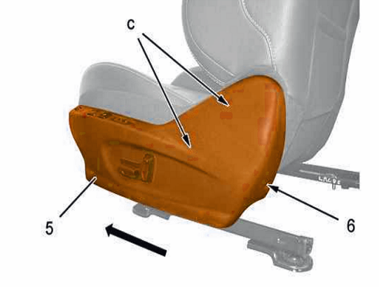

So assuming both switches are the same for both sides i was going to try and swap them around but i have no idea if i need to remove the plastic housing or if i can pop the switch out and gain access to the wiring plug as i don't want to break anything :)

The heated seat switches are identical Colin.
The seat panel trim has a bolt at the rear that needs removing, then trim tools to remove the panel carefully as the connectors and wiring are on the other side. The bolt is at the rear centre of the side trim panel (6) shown below.
The electric control panel (7) (at "h")
The electric control panel (8) (at "e")
The electric control panel (9) (at "g")
The heated seat control (10) (at "f")
Disconnect the connectors (at "d").
Remove the seat trim (5) (L.H. side).

I have managed to remove the side panel but i only have the 3 plugs for lumbar/ massage / heat buttons, i do not have item 7 which looking back at the images that would appear to be for fully electric adjustment ?
So what i have managed to do is swap the heat switch for the passenger side one and the old one does work correctly in the passenger side :(
