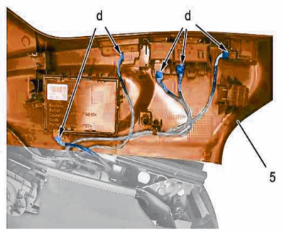

The seat panel trim has a bolt at the rear that needs removing, then trim tools to remove the panel carefully as the connectors and wiring are on the other side. The bolt is at the rear centre of the side trim panel (6) shown below.
The electric control panel (7) (at "h") The electric control panel (8) (at "e") The electric control panel (9) (at "g") The heated seat control (10) (at "f") | Disconnect the connectors (at "d"). Remove the seat trim (5) (L.H. side). |

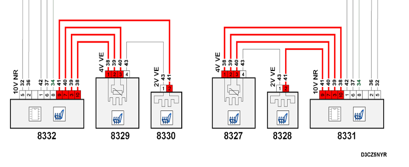

Marc sorry to be a pain but...
Looking at the diagrams would i be correct in thinking that i could actually remove the plugs from 7,8,9 and 10 and plug the whole assembly into the opposite seat wiring for test purposes?
I was just thinking that maybe item 7 could be an issue and rather than swap just the heated seat switch i should just swap the lot over to see if i get the same issues on the passenger seat which i know is working correctly ?
Colin
Colin

Hi Colin. no that won't work as although the heated seats have identical connectors, the heated seat control units have different pin-outs, so you could damage the circuit. I've highlighted some of these and you can see the pin numbers are in different positions.

Re: C4 2010 heated seat question
Am i missing something or are they not both the same pinouts??
The schematic diagrams dont show true pin positioning, only how the wires connect, they move the positioning about on the diagrams to make the diagrams easier to read so there are not too many wires crossing over each other.

Of course, I must of lost the plot on this one! Oops
At least that will test the connector blocks / switch units / rheostats - or show a wiring fault if the swap fails to work Colin.

I have managed to remove the side panel but i only have the 3 plugs for lumbar/ massage / heat buttons, i do not have item 7 which looking back at the images that would appear to be for fully electric adjustment ?
So what i have managed to do is swap the heat switch for the passenger side one and the old one does work correctly in the passenger side
