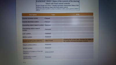

i have done a Global Test and for once no issues reported so thats a big plus
I have done the actuator tests hopefully the images will upload but no way to test the blue tooth module Think i am looking at a replacement head unit hopefully the info on the second photo can determine which unit i am looking for

So looks like there is a fault with the muting as shown on the pictures which would explain why you can't be heard by the other callers.
Have you tried pressing in the mute button a few times on the steering wheel to make sure it's not stuck? The button on the right side of the steering wheel controls immediately under the VOL - button?

But i have done another actuator test on the RNEG system, i will upload the pics via my phone then come back and explain what i did although no improvement I have tried pressing both +/- volume controls on the steering wheel and when i do this the head unit mutes the sound, not sure if it is meant to but it does.
Mute button works every time on and off and both volume controls work as they should.
However in the above pic when i press the mute button i get invalid value, but you can see from the timeline that both +/- buttons affect the mute button.
When i press the - button i get a pressed response from the mute button, yet when i press the + button i get an invalid response from the mute button.
Not sure if this is something that is head unit related or actually a fault with the steering wheel controls.

Yes, definitely some fault showing up there with the mute test showing invalid value. So there is also a Mute function on the Head Unit. It's actually the Power Off button top left. A short press turns it on and off, but a long press pauses a CD if playing, or Mutes Radio. But the dedicated Mute button also on the head unit may be faulty.
A difficult one this as it is interfering with communications. That unit I linked to has gone now - did you buy it anyway?

Hi Marc
I can't see anything else to try apart from changing the head unit as there are no faults showing yet obviously something is not right.
I assume the pressed/released values are reported via the RNEG unit and whilst the actual buttons do as required something within the unit is reporting differently?
I didn't buy the unit you linked to, i was hoping that it would be solved on the cheap
I can't find the removal keys i thought i had so guessing These are the correct ones.
Do you know the right model number i am looking for as a replacement seen quite a few different numbers.
Odd thought i had was that maybe the unit has been changed prior to our ownership and if a slightly different model could that be the cause of the issues which have been on and off ever since we have had it. The Good Lady very rarely uses the phone so no idea how long it may have been an issue ?
I have seen This but not sure if its the right one
Colin

Re: I Phone issues with MyWay / WIPNAV
That unit will be fine Colin.
I note they are also supplying the screen in the price, so no need to change that - but may be worth keeping in reserve.
I can't think what else the issue could be as I'm assuming the wiring has not been changed or anything attached - so short of that or the steering wheel control module I can only assume the Head Unit has developed a fault.
You may as a last resort consider removing the wiring plugs from the back of the unit and leave it disconnected for half an hour or so.
If doing this, do follow the BSI reset though and after the battery has been disconnected, male sure to always remove the Quadlock connector first before the screen connector and reconnect the quadlock back up last.
This would at least also rule out a connection issue at the back.
