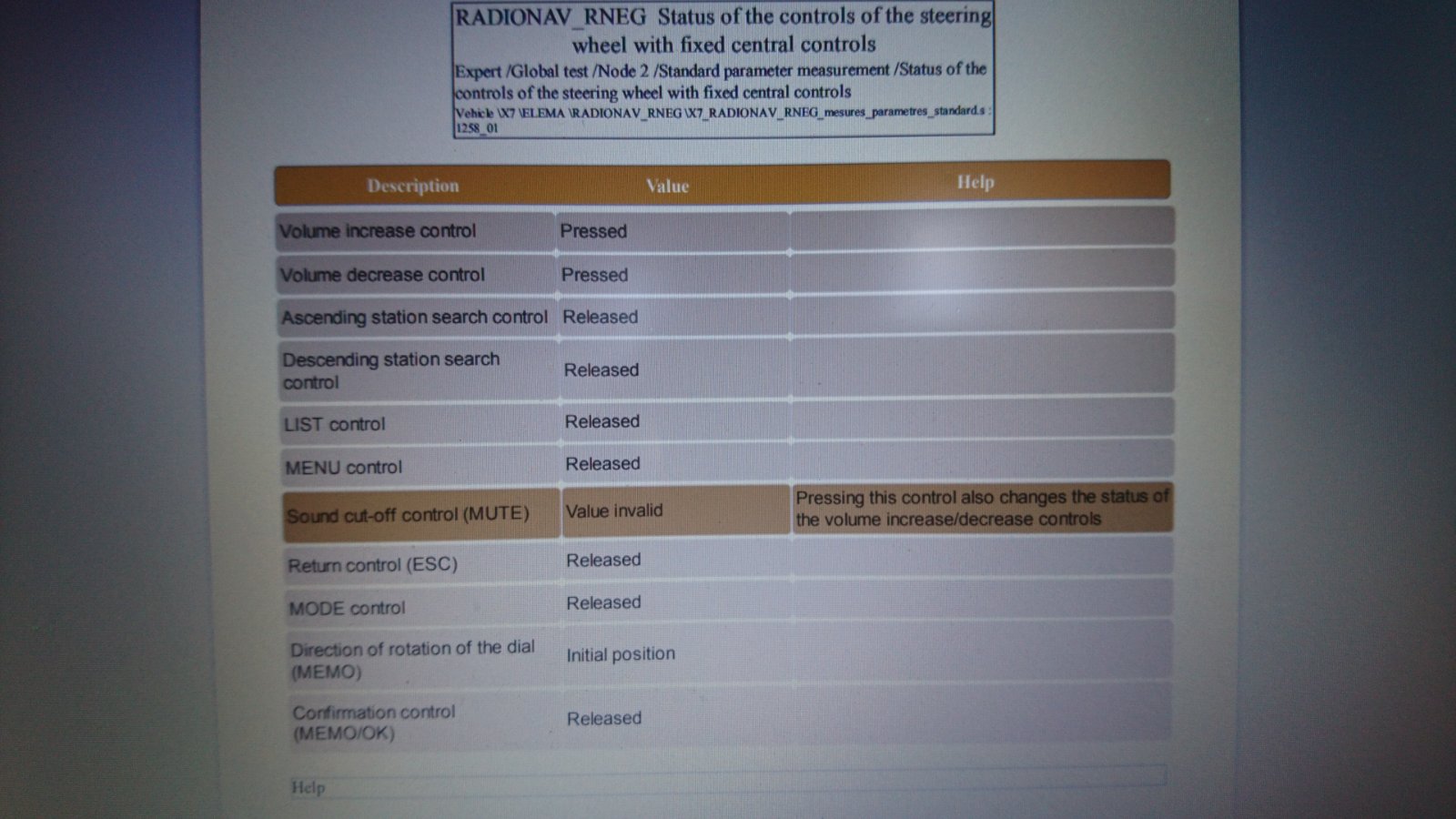

i have done a Global Test and for once no issues reported so thats a big plus :)
I have done the actuator tests hopefully the images will upload but no way to test the blue tooth module #-o

Think i am looking at a replacement head unit hopefully the info on the second photo can determine which unit i am looking for

So looks like there is a fault with the muting as shown on the pictures which would explain why you can't be heard by the other callers.
Have you tried pressing in the mute button a few times on the steering wheel to make sure it's not stuck? The button on the right side of the steering wheel controls immediately under the VOL - button?

Yes i did check that as soon as i exited the diag session, every time it muted the radio on first press and then when pressed again it un muted. i did check this half a dozen times as i thought this was maybe an issue but looking back at the pic of the mute button being pressed both the increase/decrease volume buttons change to pressed not released which i am not sure is what is meant by the comment in help section.

I have tried pressing both +/- volume controls on the steering wheel and when i do this the head unit mutes the sound, not sure if it is meant to but it does.
Mute button works every time on and off and both volume controls work as they should.
However in the above pic when i press the mute button i get invalid value, but you can see from the timeline that both +/- buttons affect the mute button.
When i press the - button i get a pressed response from the mute button, yet when i press the + button i get an invalid response from the mute button.
Not sure if this is something that is head unit related or actually a fault with the steering wheel controls.

Yes, definitely some fault showing up there with the mute test showing invalid value. So there is also a Mute function on the Head Unit. It's actually the Power Off button top left. A short press turns it on and off, but a long press pauses a CD if playing, or Mutes Radio. But the dedicated Mute button also on the head unit may be faulty.

I assume the pressed/released values are reported via the RNEG unit and whilst the actual buttons do as required something within the unit is reporting differently?
