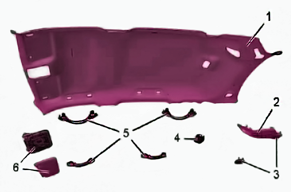

Hi Trevor
It isn't an easy affair....
The headlining has to come off officially. At the rear, the grab handles and the seat belt guides also have to be removed as well as the interior light. Officially, the whole headlining should be removed, which would also mean the front grab rails and sun visors as per the following:
(1) Headlining.
(2) Seat belt guide (rear).
(3) The mounting cover of the child seat attachment cover.
(4) Rear interior lamp.
(5) Grab handles.
(6) Sun visor.
But to do all that involves removing the quarter panel trims, the screen pillar trim pads and the roof console etc.

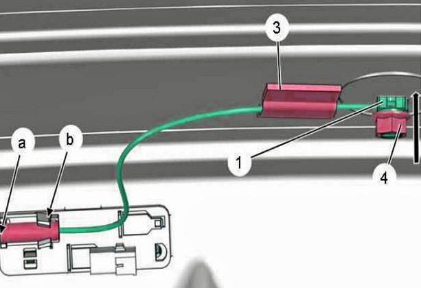

Whether you can get to it partially without doing this I can't tell you, but thios is the base and the immediate aerial wiring:
The aerial base nut is shown at (1).
Looking at the following the aerial module is located at (3), so may not be possible to access without fully removing the headlining.
But having looked at the wiring, you may not have item (3) as that may be for additional equipment - I can't be 100% sure.
Here's the unit again, so you may be able to get to this without all the removal if you can find a way in....
(1) Headlining.
(5) Grab handles.
(6) Sun visor.

Hi Marc.
Many thanks for the helpful diagrams. I'll need to now reconsider if I'll go down this route.
Seems like a big job.

Original kit is a basic RD4, mono tuner - so 1 active aerial and that's it, no USB connecting box or hands free kit.

Yes but what kind of feed is the 12v power for the amplifier? Is the amplifier a separate unit or in the base of the antenna unit?GiveMeABreak wrote: ↑14 Aug 2021, 14:06 Original kit is a basic RD4, mono tuner - so 1 active aerial and that's it, no USB connecting box or hands free kit.

Not shown as a separate amp so fed from RD4 originally I suspect.

So if its not showing an amp it's just a straight aerial directly fed to the radio antenna socket.
