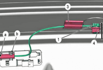

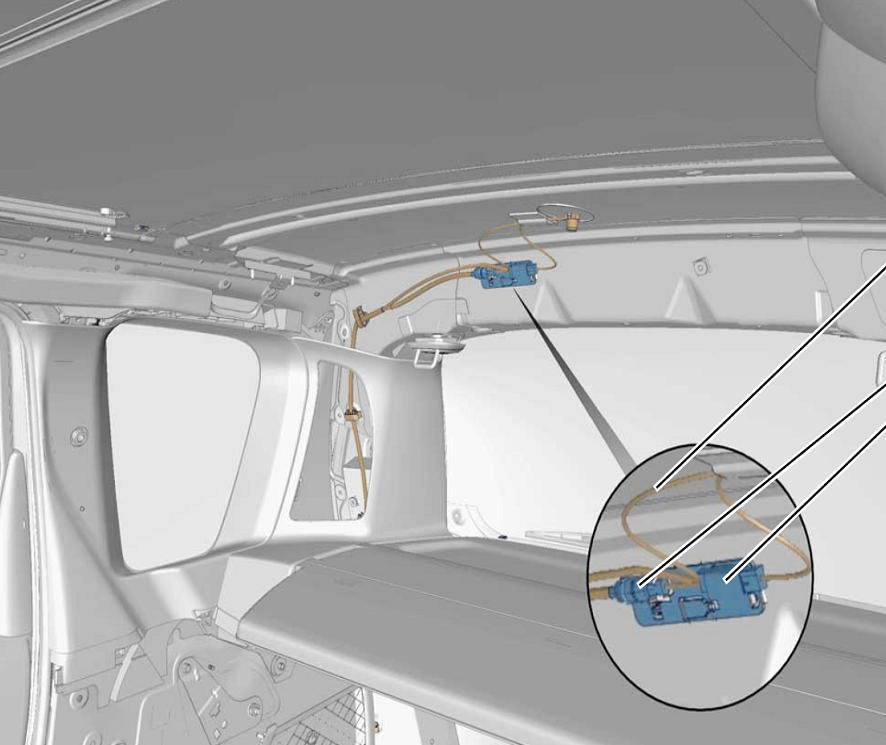

Whether you can get to it partially without doing this I can't tell you, but thios is the base and the immediate aerial wiring:
The aerial base nut is shown at (1).
Looking at the following the aerial module is located at (3), so may not be possible to access without fully removing the headlining.
But having looked at the wiring, you may not have item (3) as that may be for additional equipment - I can't be 100% sure.
Here's the unit again, so you may be able to get to this without all the removal if you can find a way in....
