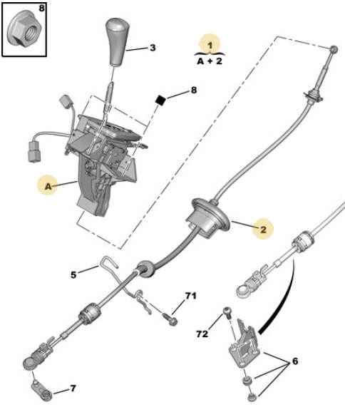

Ok, so the gear selector is item (1) which also includes the selector unit (A) and the control cable (2). The Citroen part number for this combo is: 2400GJ, but is no longer available from Citroen.
However, if it is the control cable alone you need (item (2)), then that is available.
1608888480 is the control cable alone £130.63
1440160380 is the sheath retainer for the above £32.10
Prices from Citroen today and VAT inclusive.
Both are usually needed together
I did find a genuine new control cable alone (1608888480) on ebay here for £72:
https://www.ebay.co.uk/p/15028105581

Re: C8 Gear Selector
Hello Marc - it's the selector I need apparently - so I'll set up an Ebay alert. Thank you for your help, much appreciated
- x 6945
I would double check that - as it often can be the cable itself.....
The left hand drive version of the AM6 selector unit is indeed a different part as Julian mentions, but the underlying control cable is the same for both.
