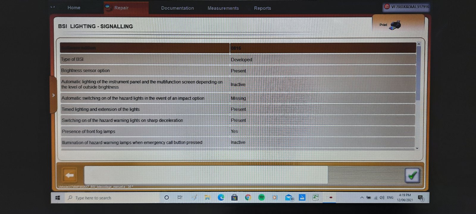

Thanks Marc for your effort in helping me . I got into the system through Lexia 3 , then BSI , then repair and got a different screen to what you have shown for lighting . I looked everywhere so I just tried to configure what I could find , which was Presence of front fog lamps . I also configured Presence of four position lighting stalk .
Then configured fog lights using the two cogs . Started the engine and set rear which showed a green light on dash then front showing an orange light got out and both front and rear working perfectly !
There is nothing saying Daytime - running lamps or Guide - me - home lamps , only Presence of parking lamps , which I set to yes and configured but it did not make the Daytime - running lamps work ???? Any more ideas please ??????

I have followed all your suggestions and taken photos of anything I have altered or tried to alter !!! I have activated the lights between Revs & speedo .
It doesn't matter where I look I can't find the screens you have shown to activate the daytime running lights . I will try and add three photos and see if you can make sense out of them . Every other light seems to work on the X7 !

As I have said in my previous message , I have activated .....THE DAYTIME RUNNING LAMPS , Guide me home lamps & Directional headlamps on the dash ! How do I find type of Daytime running lamps , all the types of lighting you have shown are not available from
LIGHTING SIGNALLING page so how do I find them please ???

I do have the sidelamps at front and tail lights , number plate lights working while driving . I sent you photos of the BSI I have for lights , nothing like what you have shown !????
On the 5 th June you sent me a list of the daytime running lamps and what to activate !!! As I said in my reply on 14 th june , they are no where to be found .
If you would tell me in detail how to find this page , I may be able to get running lights working !

Hayden - the reason I am confused is because you said 2 posts ago you had activated the DRLs and the Guide Me Home lamps on the “Dash”. The menu on the instrument panel accessed by the steering wheel scroll button would show the picture I posted earlier (white writing on black background). If you have the DRL option shown on this screen on instrument panel LCD, then as far as I can tell they are activated. Bear in mind you do need to put a tick against the option using the scroll wheel and pressing the wheel on each option to tick or untick the option. My picture above shows all 3 options unticked. Please confirm you have done this.
If the DRL option in the black picture is not present, they are not activated - then we need to check with Diagbox again. There may be a further section that needs checking.
Having said that, the different software versions of Diagbox can be different in terms of options and layout of menus, so this is why there isn’t a straight and simple answer to configuring it.
