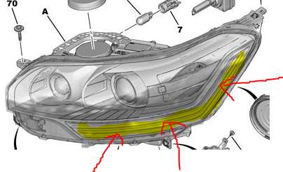

First of all can we be clear on which exact lights you are referring to?
1) You have directional Xenon headlamps. The DRL (Daytime Running Lights) are incorporated into the headlamp unit as marked in red and yellow:
2) Or are you referring to the fog lights:
or 3) are you referring to the Cornering Lighting shown below:
I suspect from your post that you may be referring to the angular / cornering lighting in the last picture and if this is correct, then the function you describe is normal behaviour. The cornering lighting operates when the headlamps are active and whist turning the steering wheel when stationary or at low speeds. They are designed to light up the corners of junctions or when going round twisty roads at low speeds. The left one operates when the steering wheel is turned left and the same for the right side when turned left, and the go off when the steering wheel is returned to the centre.
The lower fog lights incorporated into the indicator housing are simply fog lights that have to be activated manually and these operate with the main headlamps when you switch the fogs on.

Thanks Marc for clarifying a lot the lighting control with drgs and instructions . The fog lamps were what I thought , daytime running lamps !!!!
The running lamps have rever worked since I have owned the car .
I looked at the manual for light control and it didnt matter how I rotated B on the stalk , with headlights on , I could't get the front fog or rear fog lights to work ???
Any ideas ?
