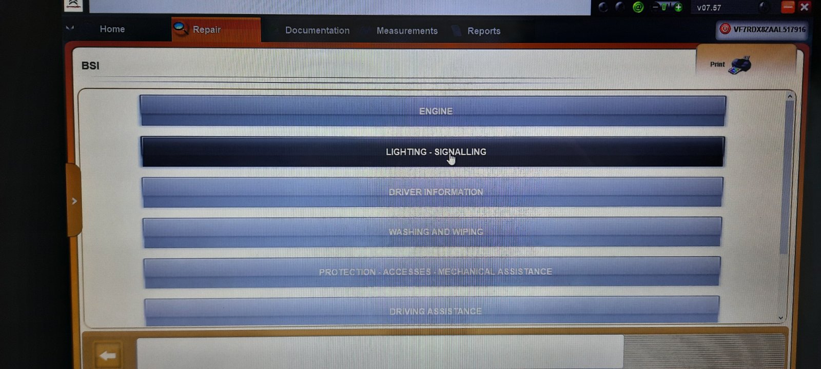

Thanks Marc for your effort in helping me . I got into the system through Lexia 3 , then BSI , then repair and got a different screen to what you have shown for lighting . I looked everywhere so I just tried to configure what I could find , which was Presence of front fog lamps . I also configured Presence of four position lighting stalk .
Then configured fog lights using the two cogs . Started the engine and set rear which showed a green light on dash then front showing an orange light got out and both front and rear working perfectly !
There is nothing saying Daytime - running lamps or Guide - me - home lamps , only Presence of parking lamps , which I set to yes and configured but it did not make the Daytime - running lamps work ???? Any more ideas please ??????

Ok, some confusion here....
Be VERY careful what you change in the BSI - some options are not what they seem - and are for different vehicles (like Peugeot) that share the same BSI but have different systems for both displaying and communicating information displays and how they handle options which are dependent on the type of displays and dash and other equipment / options fitted. Some things may seem like they are incorrect, but are in fact correct for the C5 X7 and there is no 'undo' option, so whatever you do make a screen shot before you change anything so you can revert it back again. If you change even one thing not intended for the X7, you can cause the car to become unstable and exhibit weird behaviour.
The menu above in my screenshot is not from the Lexia - it is from the car's main dashboard LCD display in between the speedo and rev counter. That menu is accessible without needing Lexia at all.
The only reason you need Lexia is to enable that menu in the car's dash lighting menu for the DRL option to be there if it is not already. Please don't change any more options until you know what youa re doing Hayden, as you could be actually causing problems.
I will locate the correct options for DRLs now that I know you are at this stage.

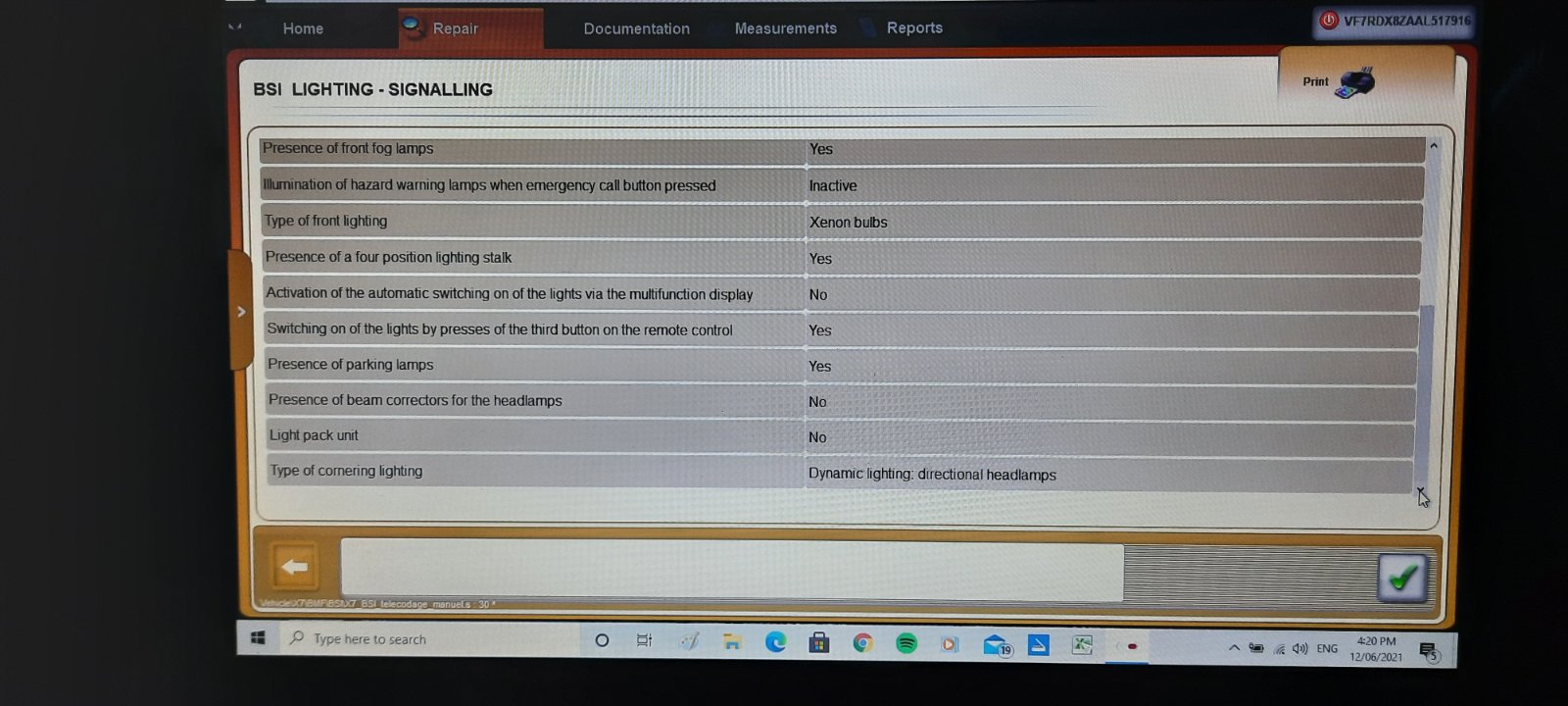

I have followed all your suggestions and taken photos of anything I have altered or tried to alter !!! I have activated the lights between Revs & speedo .
It doesn't matter where I look I can't find the screens you have shown to activate the daytime running lights . I will try and add three photos and see if you can make sense out of them . Every other light seems to work on the X7 !

That would help - use the 'Full Editor & Preview' button when replying, then you can select the 'Attachments' button and add files from your PC or phone, then use the 'Place' button to place them where you want in your post response inline with your text.
Just to clarify, DRLs must first be activated using the diagnostic tool (Diagbox or Lexia) using the options listed in my previous post to activate the DRL option in the car's instrument panel LCD lighting menu which is where you can activate or deactivate them easily in future.
I suspect if you still do not have the DRL option coming up in the lighting menu, then you have not enabled them in the BSI using the diagnostic tool. You may not have actually changed and saved the configuration.
I may have a better idea once you put some photos up.

As I have said in my previous message , I have activated .....THE DAYTIME RUNNING LAMPS , Guide me home lamps & Directional headlamps on the dash ! How do I find type of Daytime running lamps , all the types of lighting you have shown are not available from
LIGHTING SIGNALLING page so how do I find them please ???

Hi Marc
I have done evrything you suggested and still no daytime running lamps working when engine running and switch set to auto lights !!!!
I do have the sidelamps at front and tail lights , number plate lights working while driving . I sent you photos of the BSI I have for lights , nothing like what you have shown !????
On the 5 th June you sent me a list of the daytime running lamps and what to activate !!! As I said in my reply on 14 th june , they are no where to be found .
If you would tell me in detail how to find this page , I may be able to get running lights working !

If the DRL option in the black picture is not present, they are not activated - then we need to check with Diagbox again. There may be a further section that needs checking.
Having said that, the different software versions of Diagbox can be different in terms of options and layout of menus, so this is why there isn’t a straight and simple answer to configuring it.
For this reason, if you prefer, I could connect with your laptop remotely using TeamViewer and locate the options for you when you have Diagbox connected up to the car.
I think that would be the simplest and quickest way. Let me know.

I have ticked the three options between the speedo on the 14 th June !
I have checked the EasyDiagnostic YouTube site and they say that the Lexia 3 & Diagbox will not work on Windows 10 with 64 bit system , which is what I have on my computer .
That is unusual as I have been able to alter a lot so far but that be why I cannot get the BSI screen to show DAYTIME RUNNING LAMPS . What do you think ?? If this is the case I will never have running lights . I thank you for offering to remote connect to my computer but it may never work with my syatem !!! Hayden

Ok, some facts first:
Diagbox is the main programme for later vehicles (circa post 2008). It also contains the older software (Lexia for Citroen vehicles & Peugeot Planet 2000 for Peugeot vehicles that are earlier than 2008 approx.) Diagbox launches the most appropriate software for the vehicle automatically.
As for Windows 10 and 64 bit systems, the Lexia and PP2000 software components (that you don't need for your C5 X7) won't work on any 64 bit system due to them being 16 bit applications and the therefore the code used to write them back in the day.
As for Diagbox, this should work on Windows 10 32 bit no problem and even some 64 bit users have said it will work, so I've found this to be a bit hit and miss.
However, you already have been into the BSI, so it shows in your case it will work. So let's park that point for now.
I can only assume that there may be an option missing or incorrectly configured parameter, hence my offer to dial in and sort it out. Up to you - it only takes a minute to install Teamviewer and a few seconds to connect.
