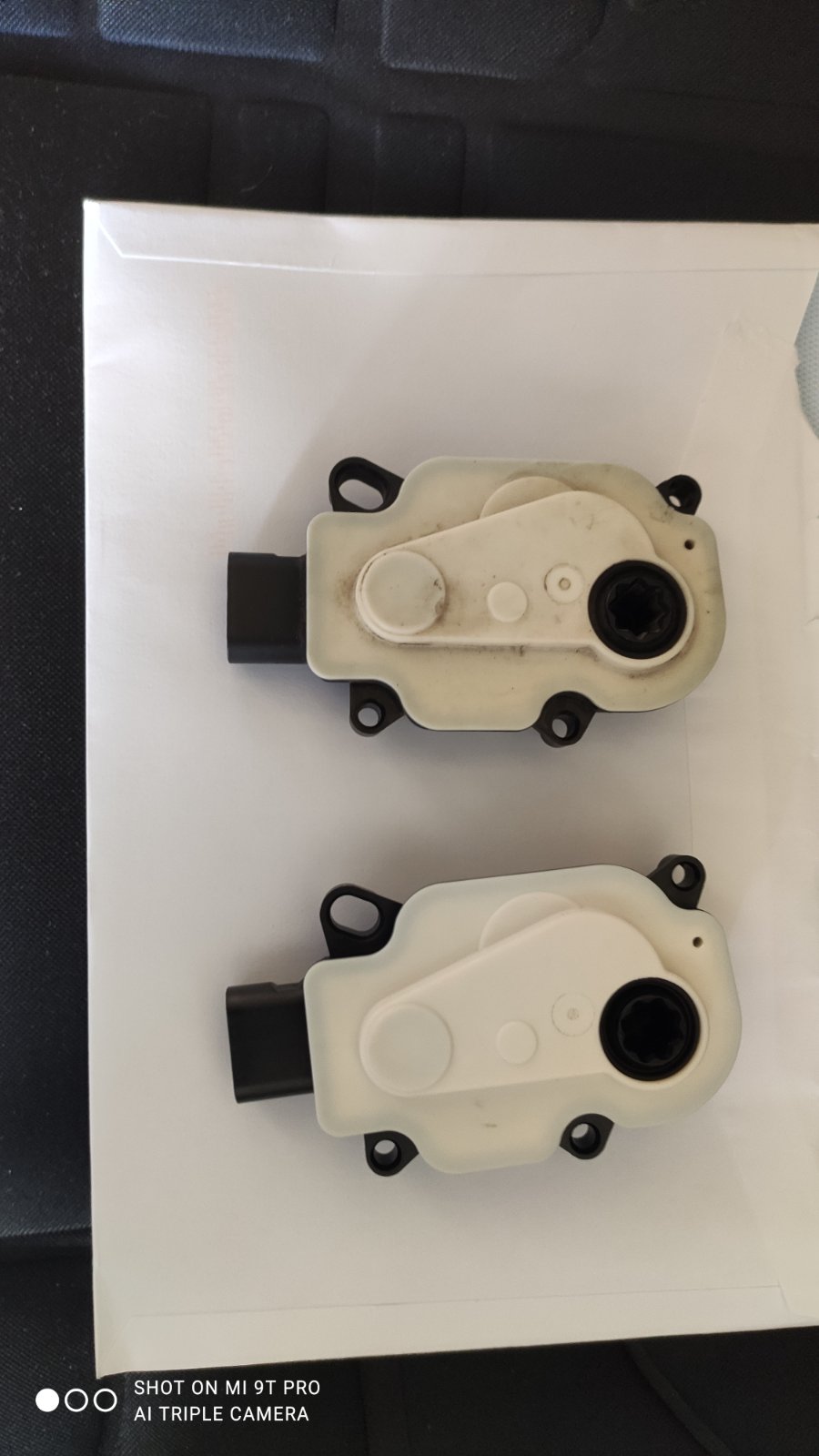

In that case, for anybody else reading this in the future, the stepper motor which was faullty and the Air Vane part which was perfect was repaired by buying the Sonceboz (Bosch) actuator separately from Ford. True cost £30-40. Mines cost £10 as a NOS part

This is the original actuator and the identical but FoMoCo branded replacement

The main vane module would be the part in an accident or pheasant strike that would get damaged but my actuator was damaged by salt spray from travelling behind an artic in late December last year. The 4 pin connector let in and held the spray water in the joint and caused all the issues. I had to replace the 4 pin plug as well which we got from the VW parts bin.

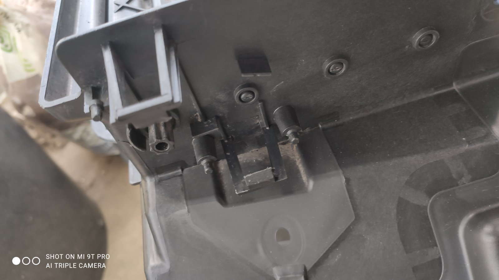

Main Air Vane Unit/ part no 30 in the pictures
You can see the progressive movement of the shutters in the 3 shots of the whole unit and the end shot shows where the actuator clips in place. The actuator is obviously a removable/replaceable part. Why I could not get only the actuator I don't know!
The vanes are completely perfect and the unit has washed up well.You can see the progressive movement of the shutters in the 3 shots of the whole unit and the end shot shows where the actuator clips in place. The actuator is obviously a removable/replaceable part. Why I could not get only the actuator I don't know!
