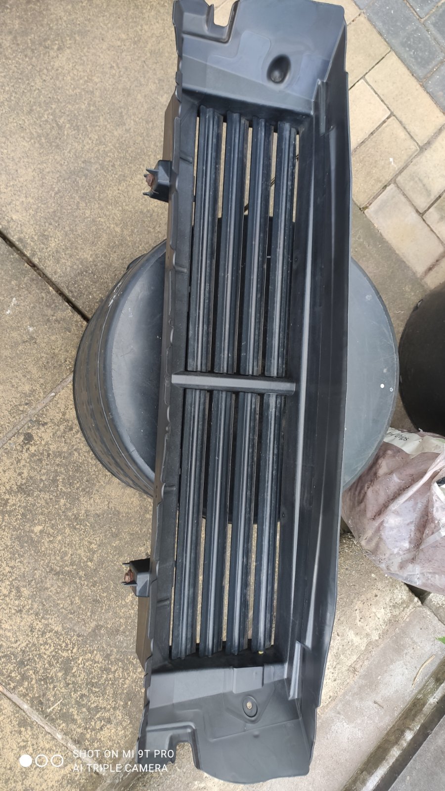

the following numbers appear on my 3008 Hybrid4 Controlled Air intake Module.
Can anyone shed any further light on it and find it in any parts list?
T84
96 726 968 80
>PP-GF30/SEBS <
RA-GI

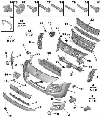

I'm having trouble identifying that from your picture as it is too close to put it in context with its surroundings, but these are the bumper assembly diagrams and the nearest thing I can locate to it is item (30) which is the Pilot Air Intake Module. There are several diagrams for your VIN depending on the build, so I've included both:
Mid LifeExcept Mid Life
Hopefully you'll know which version you have from the other features of the body work / lighting as there are specific differences you can match up.

It is part 30 in the Except Mid Life picture

Ok, then that is part: 1608950980 - sitting down? Price is £297.06 inc. VAT.

This is the original actuator and the identical but FoMoCo branded replacement

Post by Dormouse »
The main vane module would be the part in an accident or pheasant strike that would get damaged but my actuator was damaged by salt spray from travelling behind an artic in late December last year. The 4 pin connector let in and held the spray water in the joint and caused all the issues. I had to replace the 4 pin plug as well which we got from the VW parts bin.

Main Air Vane Unit/ part no 30 in the pictures
The vanes are completely perfect and the unit has washed up well.
You can see the progressive movement of the shutters in the 3 shots of the whole unit and the end shot shows where the actuator clips in place. The actuator is obviously a removable/replaceable part. Why I could not get only the actuator I don't know!
