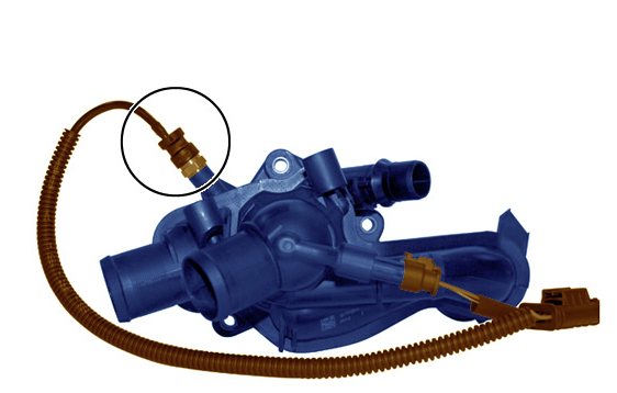

Think I'm going to have to get the garage to do it as I don't have a vacuum tool or the filling cylinder thing :-(
Any idea where the bleed screw is for my vehicle.
Cheers
Zane
x 6947
Re: C4 Pic 2014 Exclusive (B87) - Replacing Coolant
It should be on the Outlet Housing, but....
There can be 3 variations of these and depending on which one you have, there may already have been a modification.
This one shows the bleed screw that has been removed and replaced with the engine coolant temperature sensor and wire modification:
