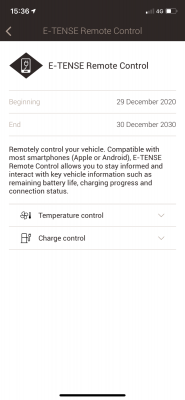

Yes followed to the letter and the service says activated under my services on the app. But on the Home Screen of App nothing new appears and we get a little message “ state at -/—“ at top.

Ok and did you activate and register it and pair with the key as per this? Their videos are all over the shop, but looking at your screen it is not displaying the status (date / time) is missing on the App, which is indicative of the App not being connected to the vehicle or not being able to communicate. So if it has been paired and registered with your smartphone (and assuming your smart phone is supported) could it be the WiFi signal / connection?
