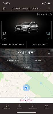

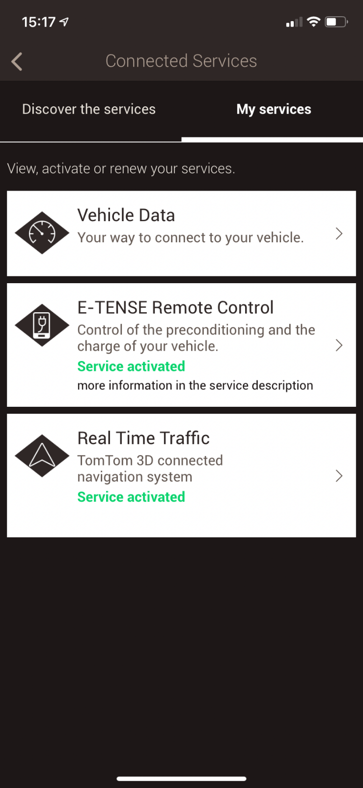

Yes followed to the letter and the service says activated under my services on the app. But on the Home Screen of App nothing new appears and we get a little message “ state at -/—“ at top.

Ok and did you activate and register it and pair with the key as per this? Their videos are all over the shop, but looking at your screen it is not displaying the status (date / time) is missing on the App, which is indicative of the App not being connected to the vehicle or not being able to communicate. So if it has been paired and registered with your smartphone (and assuming your smart phone is supported) could it be the WiFi signal / connection?

Yes it was step 3 sitting in the car with key and phone to pair which made the service go green "service activated". I have connected my car to my home wifi, work wifi and mobile hotspot and all say connected but still no joy. If I got into Connected Services via the console in the car is just get a red exclamation mark and information telling me about the MyDS app.

Ok, so that sounds like it hasn't been activated from their end. Similar services on my Connected Nav system require me to log into the App and then to select the relevant service and enable it from there - even the free ones have to be enabled before they become active. So I would suggest logging into your app, ensuring the VIN is correct and then checking through the available services and checking to ensure they are enabled from there first.
