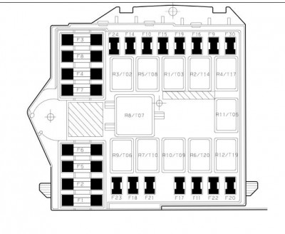

Does anyone know the location of the relay? I see there's one on the inside of the wing behind the headlight but other than that can't see any obvious ones

Re: Citroen relay fuel issue
Post by wheeler »
whats the last 8 digits of the VIN?
It will be in the under bonnet fusebox behind the LH headlamp.
Relay T10
The last 8 digits of the VIN will confirm.
Post by Stuwie93 »
11087974 o okay. So it's just one of the smaller relays. I was expecting a big one on its own.
Post by wheeler »
I have updated the previous picture, the position is the same but it may be marked as either R7 or T10.
Post by Stuwie93 »
Top stuff. Thank you so much

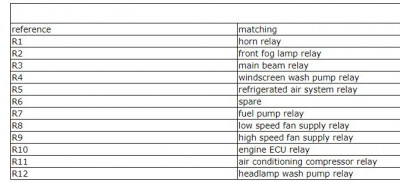

Could you tell me what R4/t17 is for? I've temporarily used the relay from there. Been for a drive and the van seems fine so either it's not important or something wasn't working before there either
Post by wheeler »
R1-R12 are on the last pic I posted.
