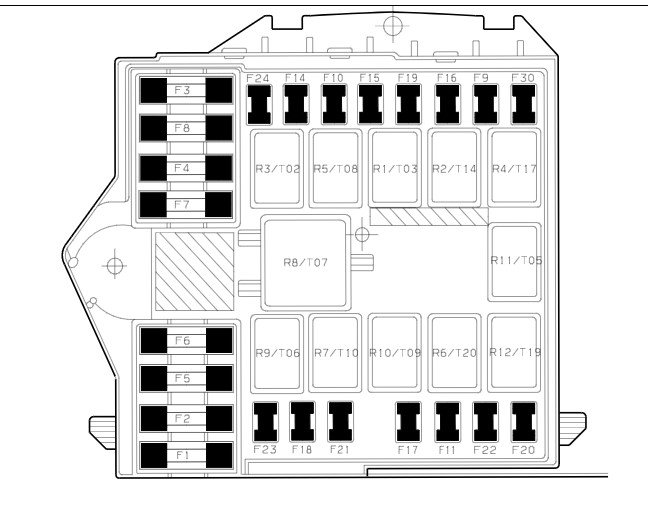

I have a 2.2 2007 Citroen relay. Does anyone know where I can find a fuse/relay diagram?
I need to find the fuel pump relay and the only diagrams I can find don't match.
The fuse box under the bonnet has a diagram inside the box but where it says the relays should be there's nothing. The lid must be a generic part so my relays are located somewhere else.

Does anyone know the location of the relay? I see there's one on the inside of the wing behind the headlight but other than that can't see any obvious ones

whats the last 8 digits of the VIN?
It will be in the under bonnet fusebox behind the LH headlamp.
Relay T10
The last 8 digits of the VIN will confirm.
Relay T10

11087974 o okay. So it's just one of the smaller relays. I was expecting a big one on its own.

I have updated the previous picture, the position is the same but it may be marked as either R7 or T10.

Do you have the full list. I've got it working but would like to make sure all the others are okay whilst I'm in there.

Could you tell me what R4/t17 is for? I've temporarily used the relay from there. Been for a drive and the van seems fine so either it's not important or something wasn't working before there either

R1-R12 are on the last pic I posted.
