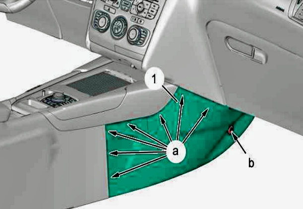

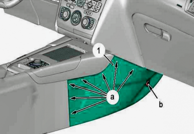

It shouldn't be too difficult, just get some trim removal tools:
Using trim removal the tools, unclip:
Clip (at "b")
The trim (1) (at "a")
The diagram shows a left hand drive, but is a symmetrical operation on both sides.
Clip (at "b")
