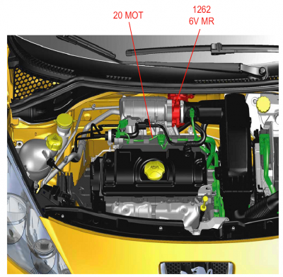

Your symptoms are all related to P2101: (but it won't be the anti-pollution lamp that is lit - it should be the engine management light as there is a difference).

So the engine ECU has limited engine speed and disabled the functions listed above until the fault is rectified.
As per your PM, here's some wiring info for you:
The Main Engine ECU Diagram
1320 is your Engine ECU
1261 is the Accelerator Pedal
1262 is the Motorised Throttle

1218: throttle potentiometer position signal 1
1219: throttle potentiometer position signal 2
1367: motorised butterfly potentiometer earth
1372: Throttle motor command by -
1371: Throttle motor command by +
1220: throttle potentiometer supply 5V
