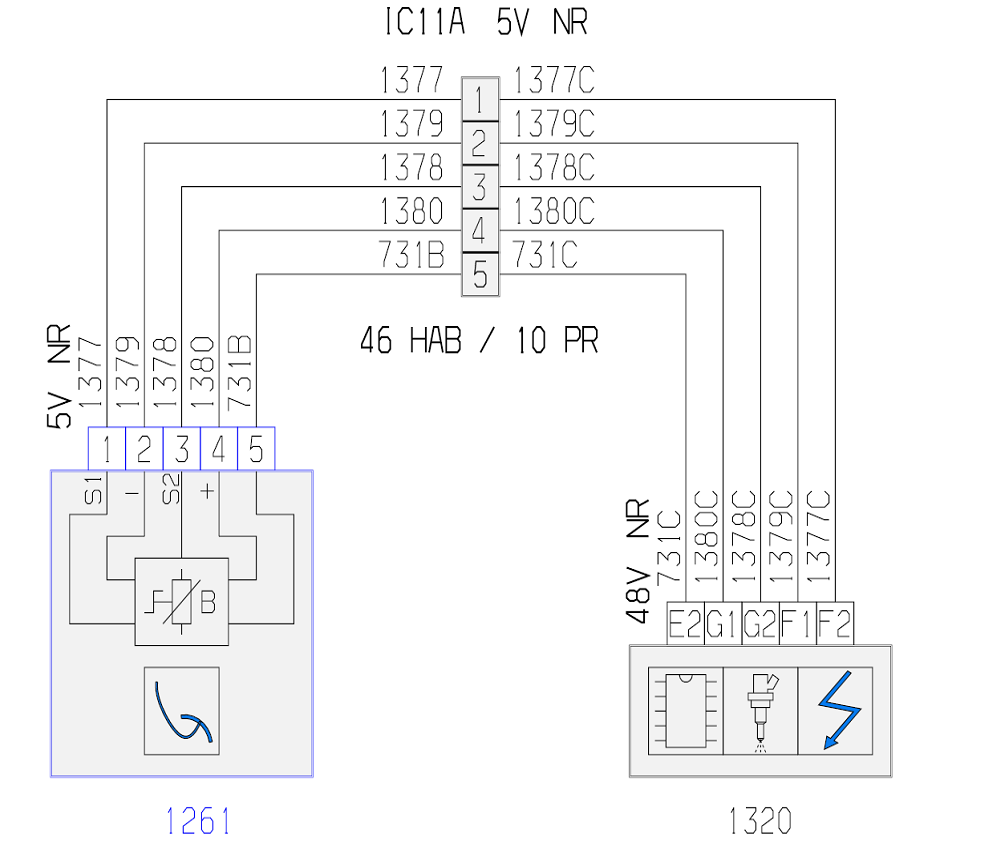

The Main Engine ECU Diagram
1320 is your Engine ECU

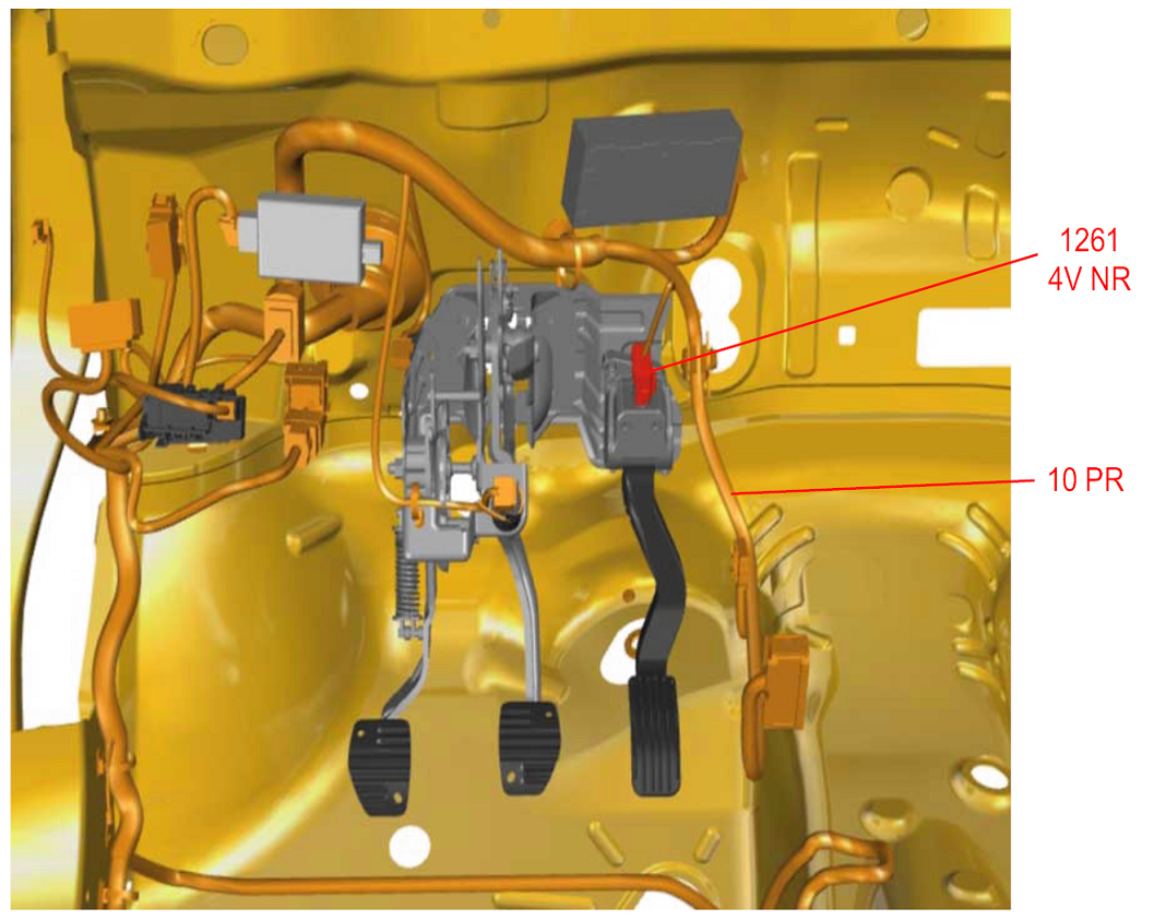

1261 is the Accelerator Pedal

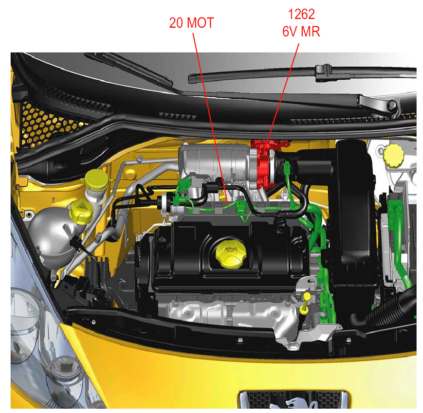

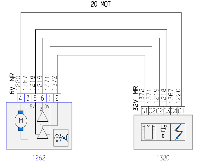

1262 is the Motorised Throttle

Accelerator Connection

Throttle Motor Wiring
1380C: + 5 volt accelerator pedal position indicator power supply
1378C: Accelerator pedal 2 position info
1466C: accelerator pedal 2 position earth
731C: accelerator pedal point of resistance / signal
1379C: accelerator pedal position earth
1377C: Accelerator pedal 1 position info
1218: throttle potentiometer position signal 1
1219: throttle potentiometer position signal 2
1367: motorised butterfly potentiometer earth
1372: Throttle motor command by -
1371: Throttle motor command by +
1220: throttle potentiometer supply 5V

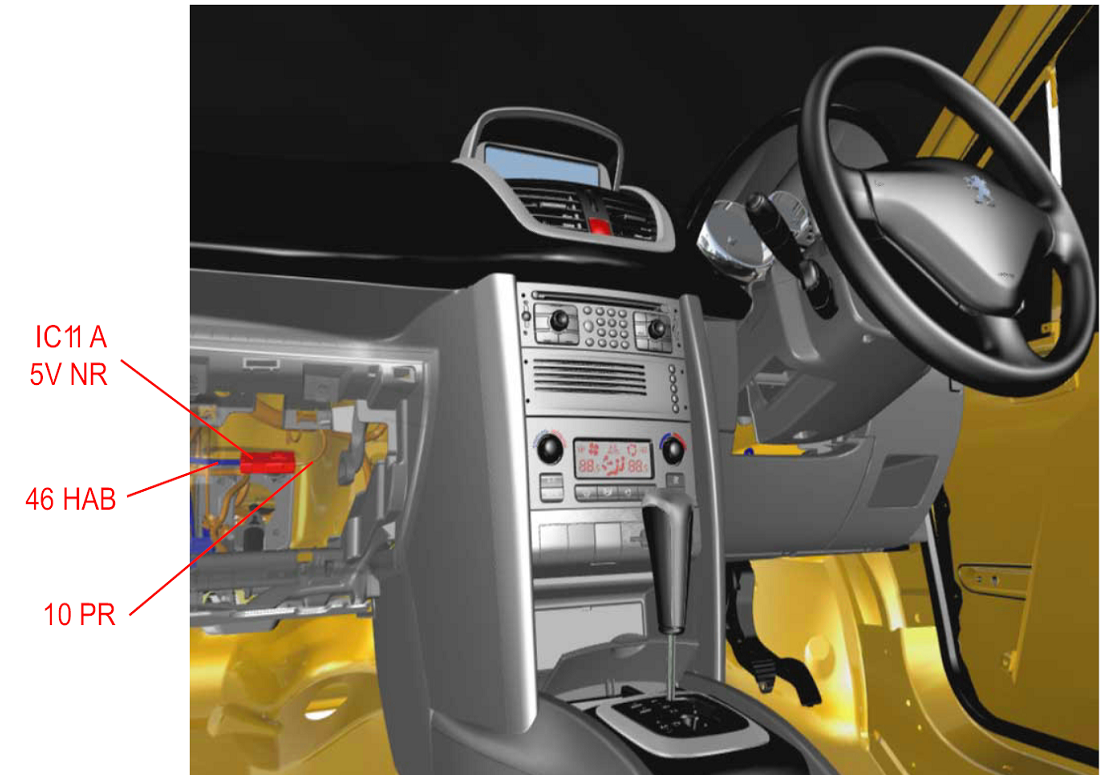

Here is the interconnection for the accelerator harness where it connects to the passenger compartment
IC11A Interconnection from Accelerator to Engine ECU
