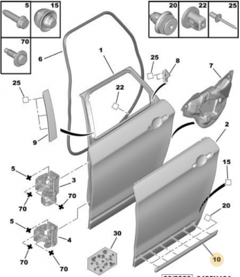

Have a look at the diagram above.
I think item (10) is what you are after, but correct me if I'm wrong. Chromium Grey is the colour for your car and this is reflected in the part numbers below:
The rear left side door protector part number is: 8546W5
The rear right side door protector part number is: 8546W7
Both are £100.15 each inc. VAT from Citroen as of today.

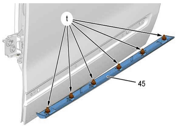

As for fitting:
Unclip the clips (at "t") using trim removal tools.
Remove: The protector (45).
The clips item (20), are part number: 856564 and cost £2.95 each and need to be replaced if they break on removal of course .
