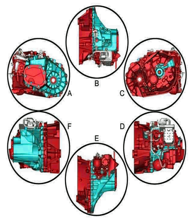

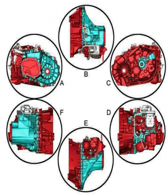

The tank should not be empty. I am just advising you the way you need check the tank level, so it accounts for all the hydraulic oil in the system. Filling it up when the actuators are already full of oil will very likely over-fill it causing extra pressure in the system and that may lead to a leak. Unfortunately I can't tell you what the level should be when the system is properly filled and then pressurised.
If you have pictures of where the oil is leaking from (the source of oil the leak, not where it is ending up) I may be able to help - but is going to be difficult on a Forum.
Or if you can use the diagram below and tell me which section:
