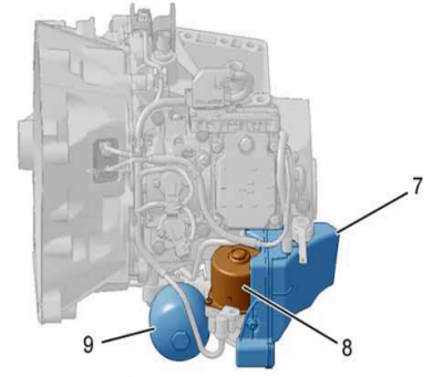

Re: DS5 strange noise from EGS
You have a Hybrid 6 speed piloted manual box
Your hydraulic reservoir is number 7 below.
(7) Hydraulics reservoir.
(8) Electric motor.
(9) Pressure accumulator.
(8) Electric motor.
yeah I know this.. (how come right)GiveMeABreak wrote: 24 Aug 2020, 15:02 You have a Hybrid 6 speed piloted manual box
(8) Electric motor.
