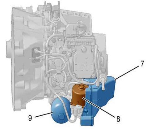

Re: DS5 strange noise from EGS
You have a Hybrid 6 speed piloted manual box
Your hydraulic reservoir is number 7 below.
(7) Hydraulics reservoir.
(8) Electric motor.
(9) Pressure accumulator.
(8) Electric motor.

yeah I know this.. (how come right) last summer had a dmf and clutch change and was perfect until february or so. But the first oil drop I saw was 2 weeks ago. Checked the hydraulic reservoir is number 7 and it was a bit below the MAX mark.. Went to croatia last week ~1800km and yesterday night heard this noise. And today checked the oil tank and it has a little bit fluid in the bottom..GiveMeABreak wrote: ↑24 Aug 2020, 15:02 You have a Hybrid 6 speed piloted manual box
(8) Electric motor.
The tank should not be empty. I am just advising you the way you need check the tank level, so it accounts for all the hydraulic oil in the system. Filling it up when the actuators are already full of oil will very likely over-fill it causing extra pressure in the system and that may lead to a leak. Unfortunately I can't tell you what the level should be when the system is properly filled and then pressurised.
If you have pictures of where the oil is leaking from (the source of oil the leak, not where it is ending up) I may be able to help - but is going to be difficult on a Forum.
Or if you can use the diagram below and tell me which section:
