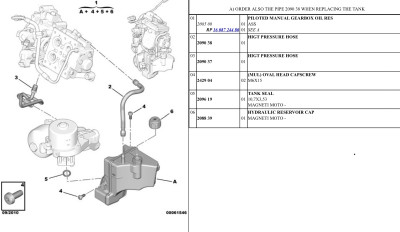

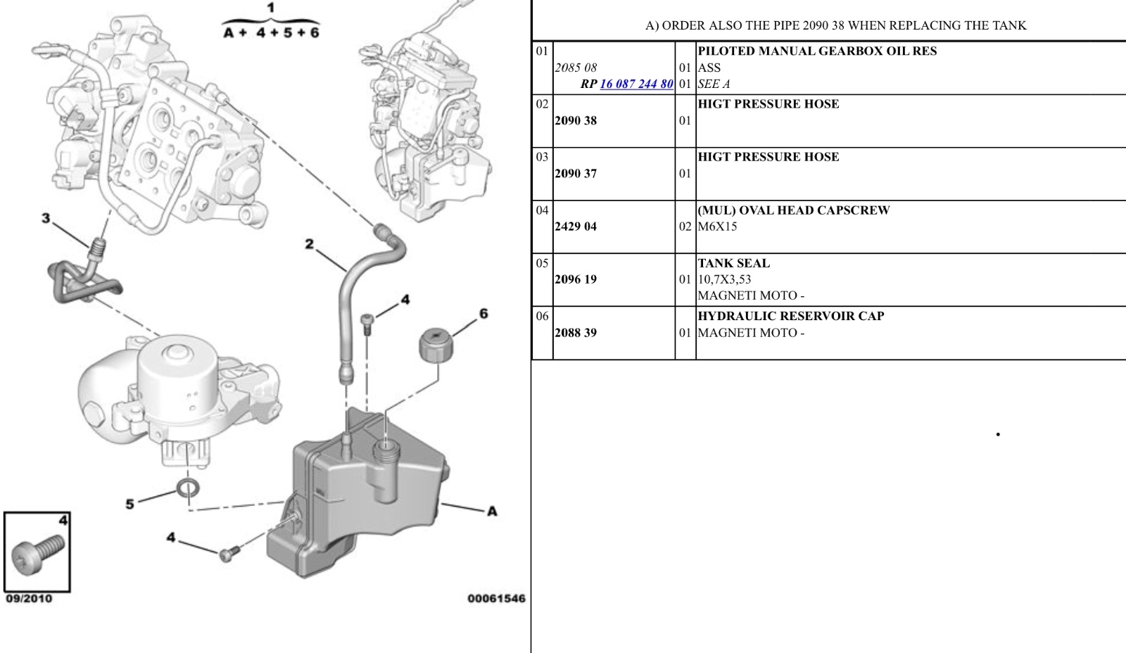

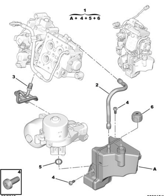

The pipe is available in spare parts, so should be accessible, I thought I would just mention it. Now we have your VIN We see you have the C4 PICASSO ESTATE - LEISURE 2.0 i 16v 143 (EW10A) piloted manual gearbox 6 (2007).
Here’s the diagram and the pipe referred to in the Forum link is item 2, part number: 209038 in case this is your issue, price £68.32 inc. VAT.
Click to Zoom

GiveMeABreak wrote: 10 Oct 2018, 23:26
Thank you for all that. I've been under it today and i'm a little baffled to be honest. The actuator oil reservoir is really low, but it doesn't appear to be leaking from there, unless it's managed to find a crevice that i can not see. I've uploaded another video.
So what sort of pressures are we talking about here? I was hoping i could top it up then at least get it running to see where the oil leak is coming from to give me a better idea. All the driveshaft seals appear to be fine too, so i'm thinking it is this or something else, but i dont like the sound of this one!! I take it the Diagbox is like the CanClip, can we openly talk about it on here?RichardW wrote: 11 Oct 2018, 12:05 Unfortunately doing anything with the EGS (even checking the oil level) requires Diagbox as you need to de-pressure the actuator (although if it's leaked all the oil out, that's done already!); then you need to re-pressure and re-program it (which seems to have a <50% chance of actually working!).

Do you think that is is leaking from the oil tank then? It's a little hard to get the perspective from the angles but a useful video
That large sphere is the actuator accumulator sphere that stores pressure.
| The oil tank is Part 1608724480 £51.31, but needs the seals (4), (5) & (6) as well as the previous pipe replacing too if changing. |
