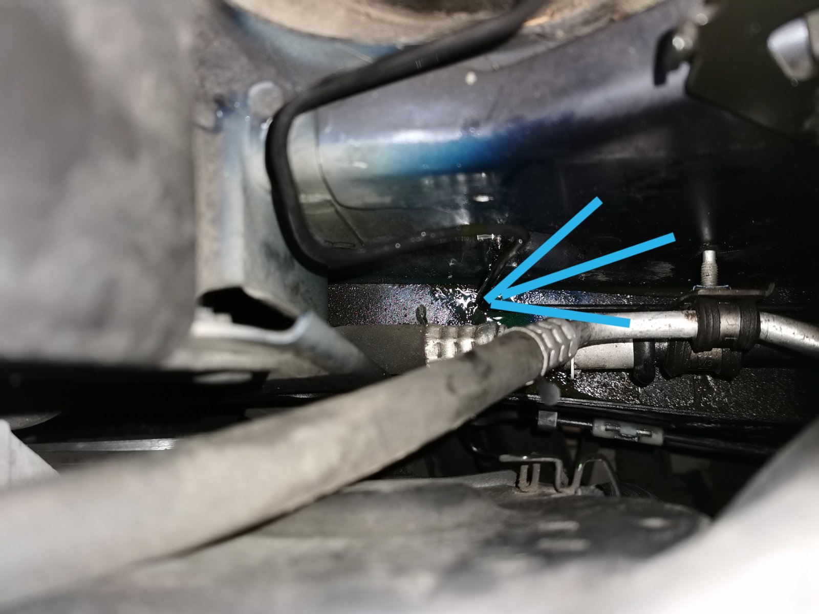

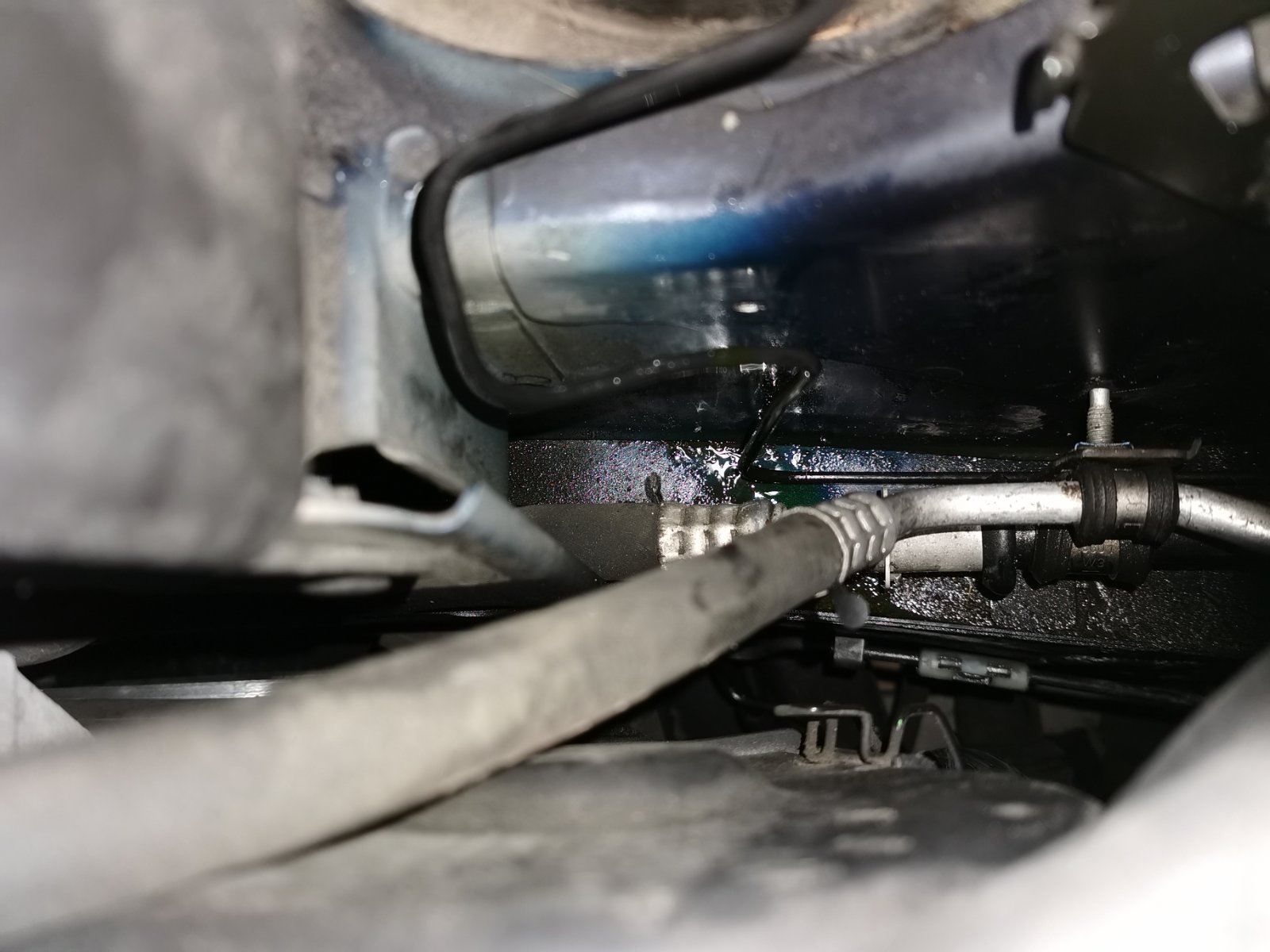

I have really annoying leak coming from the right front corner of my mk1 Xantia, where there are no hydraulic lines ?? It dosnt leak while the motor is running, only when the motor is turned off and the suspension sinks. There is a lot of oil on the tray / shelf below the washer fluid reservoir, I cleaned that area, ran the motor and turned it off and within a few minutes observed oil flowing down that tray towards the front of the car. I thought it might be the high pressure line for the strut, its dry where it enters the strut but appears
wet further down ?? Could this line have fractured and where does that line terminate ?

Where exactly is the wet patch ?. A photo would help but one possibility is the rubber leak off pipe at hydraulic strut. If it's not on right it causes a small leak.

The wet patch is under the bumper on the right hand side, it's running down that tray / shelf in the pic. Is that return line under much pressure?

Found it, damaged high pressure line to the strut, right behind the 90 degree clip that secures the line to the inner wing, I can see this is going to be a mission to fix.....
