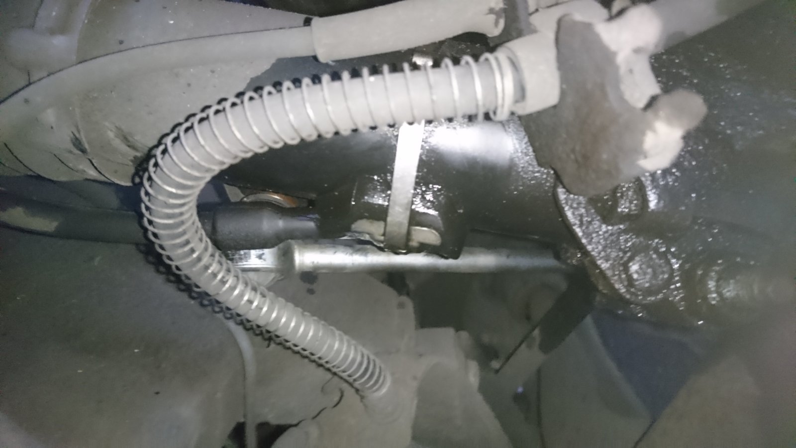

Why do they mis behave just at the wrong time, lavished lots of TLC, treat her with respect and she goes and springs a leak :twisted:
I am talking about my Xantia in my profile not SWMBO :rofl2:
Will get pics up in a bit.

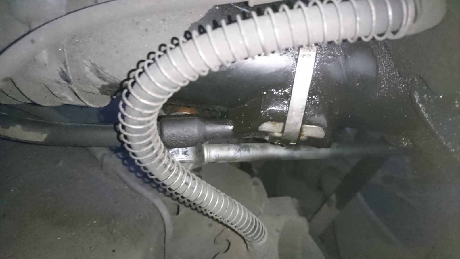

Leaking from the N/S/F strut, think it is the return pipe [-o<
Not leaking like a tap running but enough to give concerns.
It is leaking from around the clamp line, dry where the pipe feeds in/out, seems to be dry around the edges above the clamp line.
Apologies for the pics on the slant, just the way i held the phone to take pics.
Vin is in my profile but it is a 1999 2.0 Hdi non hydractive poverty spec :)
Just need it to last another 70 miles then i can park it up and use the C4 ( gets a reprieve ) as we take ownership of the boys C5 saturday morning.
Convinced i have seen this issue posted before but cannot find it or how to fix it

The return hose is still available, e.g. https://rover.ebay.com/rover/0/0/0?mpre ... 1245304649
But with the demise of spares for early C5s they might get harder to find.

What I used for this job were cable ties above and below the clip-line to hold the rubber block in place, tightened until the clip could easily be fastened with a pair of pliers.
x 1746
Re: Xantia LHM leak
The return hose and clip (same as on XM) still available from Citroen.
Make sure to clean up (and dry off, to prevent slippage) the contact area on the back of the strut, and position the hose accurately over the hole.
Good tip from Mike about temporary clamping with cable ties, while the metal clip is fitted.

Hydraulic leak-back hose - 95 050 399
Tightening collar (circular clip) - 96 127 591
Both still available. Marc will probably be able to look up prices.
No need for lift or ramp.
Suspension on highest; jack car so wheel clears the ground, and support the body; remove wheel.
Good access.
Worth having a mirror handy to see the back side of the strut, and exactly where the exit hole is.
Keep grit out of things! :wink:
