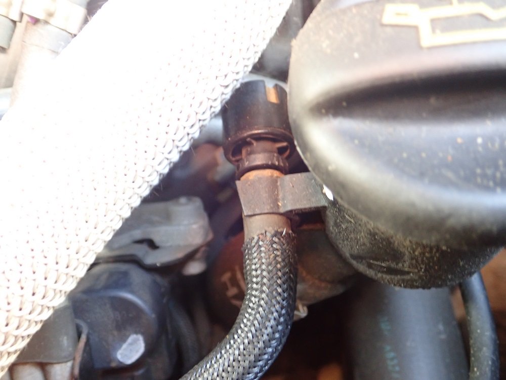

Looking at live data on Lexia one day into testing, I noticed turbo pressure 2 was reading atmospheric, which it didn't seem to when I looked before. This seems something to do with the engine being cold? At this point I should have used the Mityvac pressure mode to check pressure 2 sensor but I looked at the sensor on the front of the engine and thought it the same. If we still had access to PSA parts, I would have realised the two pressure sensors are slightly different - one for tube and one for hole with an O ring. I gently pulled the front sensor (pressure 1?) and it broke, leaving most of its stem and O ring near where the EGR pipe enters the intake. Then I realised it was no use as a substitute, finally tested both sensors with the Mityvac and they seem fine from small to large increases over atmospheric.
To remove the broken pressure 1 sensor stem I will have to remove the butterfly valve so the plastic doesn't go into the intake. To keep going, it's broken anyway, I tried some superglue on the recessed stem and restarted.

I feel a fool for breaking the front pressure sensor, but it is meant to come out and is likely trapped by aluminium corrosion. The DIY car parts market in France is years behind the UK, lucky if they even ship next day never mind have it in your hands. I have ordered the two pressure sensors and the vacuum solenoid, not because I believe they are all needed but it is so slow getting parts here. Is this anything to do with sensors, or should I be looking at EGR (at least ticks on test activate) or turbo or perhaps put some LHM into it?

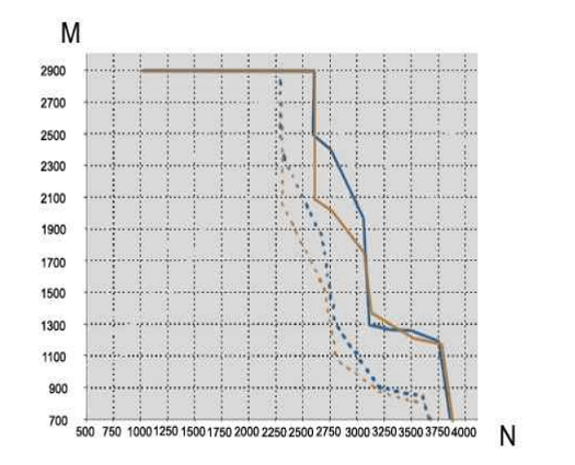

Approximate limits of the operating zones:
c: Non-regulated single turbocharger zone.
d: Single turbocharger with "Waste Gate" regulation zone.
e: Transition or single turbocharger with VT2 regulation zone.
F: Dual turbocharger zone.
G: Torque (Nm).
H: Engine speed (rpm).
Key:0
LineDesignation
PinkStart of switch to transition or limit of switch from 2T to 1T
GreenLimit of switch to transition 1T to 2T
Dotted line : GreenEnd of the VT2 regulated single turbocharger mode
Dotted line : BlueSwitching limit for a forced transition from 1T to 2T
Dotted line : BlackSwitching limit for a forced transition from 2T to 1T
RedEngine operating zone limit
Hatched zonesOperating zones which are prohibited in single turbocharger mode (Accessible in dual turbocharger mode)
The zone outlined in green is a compromise zone, it imposes operation in 1T mode even though the consumption would require operation in 2T mode. The operating mode chosen in this zone therefore depends on the operation of the engine (stable, acceleration, ...) and the requirement sensed by the driver.
During sharp acceleration, the transition is delayed until the forced limits corresponding to the limits of operation of the compressors.
There are two types of transition depending on the discharge of the turbocharger.
During a transition, the VT2 valve regulates the turbocharging pressure without being fully open. The transition is referred to as "normal". The transition time is between 500 ms and 1 second.
If the pre-rotation of turbocharger 2 has not begun at the time of the transition, the transition is referred to as "forced transition".
Note: The zones represented do not correspond to the operation during sharp acceleration.

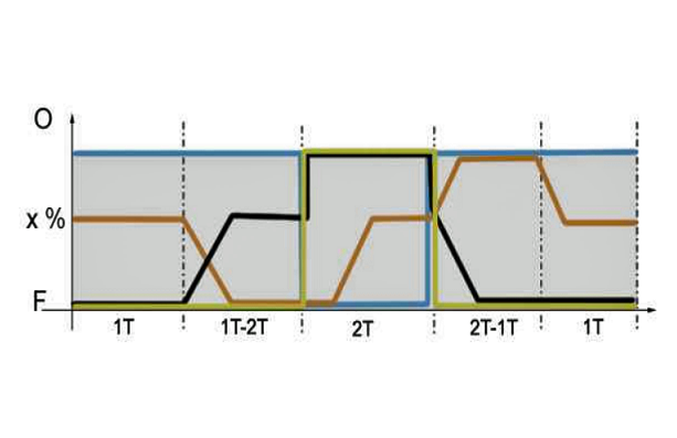

Key.
O: valve open.
F: Valve closed.
1T: Single turbocharger mode.
1T-2T: Transition from the single turbocharger mode to the dual turbocharger mode.
2T: Dual turbocharger mode.
2T-1T: Transition from the dual turbocharger mode to the single turbocharger mode.
colourvalveDesignation
BlackVT2Turbocharger turbine isolation valve
RedVT1 or WG"Waste Gate" valve
BlueVrecTurbocharger 2 compressor air recirculation valve
GreenVC2Turbocharger 2 compressor isolation valve

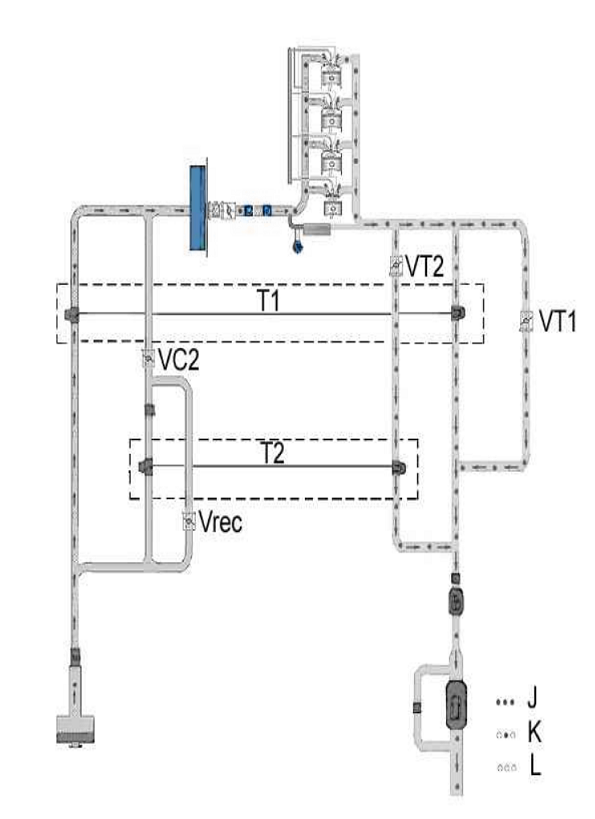

Air circulation (as per arrows):
  • J: Exhaust gas
  • K: Exhaust gas + air
  • L: Air
The VC2 turbocharger isolation valve is closed and the "Vrec" air recirculation valve is open permitting isolation of the turbocharger 2 compressor.
The VT2 turbocharger isolation valve is closed permitting isolation of the turbocharger 2 turbine.
The VT1 "Waste Gate" valve regulates the exhaust gas.
Note: The diagram is only a symbolic representation of the air supply function.

Solid blue line: Switch from single turbocharger to dual turbocharger mode from 0 to 1000 m.
Solid red line: Switch from single turbocharger to dual turbocharger mode at 1500 m.
Dotted blue line: Switch from dual turbocharger to single turbocharger mode from 0 to 1000 m.
Dotted red line: Switch from dual turbocharger to single turbocharger mode at 1500 m.
Depending on the engine speed and the boost pressure reference value, the engine ECU gives the order to switch to single turbocharger/dual turbocharger transition or to dual turbocharger/single turbocharger transition.
The transition switch graph differs in relation to the altitude (Atmospheric pressure).
The order to switch to dual turbocharger is also given when a system fault is recognised by the pressure sensor downstream of the turbocharger 2 compressor (Example : VC2 valve open).
The transition may be suspended in the event of sharp acceleration. The rapid increase in torque means that the transition must take place as late as possible. The transition takes place when the compressor enters the forced transition zone.
A single turbocharger/dual turbocharger transition may be requested depending on the use of the engine.
A dual turbocharger/single turbocharger transition may be requested if sharp acceleration is detected to improve the low engine speed low load performance in dual turbocharger mode.
Regulation
Depending on the engine speed and the boost pressure reference value, the engine ECU gives the order to switch the regulation from the "Waste Gate" valve to the VT2 valve or from the VT2 valve to the "Waste Gate" valve.
The order to switch from VT2 valve regulation to "Waste Gate" regulation may be given if a C2 downstream pressure sensor fault is recognised.
Internal diagnostics
The calculation of the reduced flow and the calculation of the compression rate makes it possible to identify whether compressors 1 and 2 are in a critical zone (oil leak, over-revving and pumping).
Forced transition
A request for forced transition to the dual turbocharger is issued if compressor 1 has an "oil leak" or "over-revving" status or following sharp acceleration. The rapid increase in torque means that the transition must take place as late as possible. The transition takes place when the compressor enters the forced transition zone.
A request for forced transition to the single turbocharger is issued if compressors 1 and 2 are at the "pumping" status.
The forced transition has special synchronisations, the opening time of the valves thus permitting offsetting to the limit of the switch to transition zone.
In order to delay the transition phase and permit the forced transition phase, the engine ECU delays the control of the Vrec and VT2 valves.
In order to extend the transition phase, the engine ECU controls VT2 and allows a period of time to elapse before controlling the Vrec valve.
The forced transition control phase lasts 500 ms.
Note: The pumping, oil leak and over-revving statuses are detected by the "Internal diagnostics" function.
Back-up mode
The diagnostics function incorporated in the engine ECU permits activation of the emergency strategies associated with the detection of faults:
  • Detection of a positive loop difference relating to the position of the VT2 valve. The engine ECU forces the dual turbocharger mode prohibiting the single turbocharger with VT2 regulation mode and requests a reduced flow.
  • Detection of a negative loop difference relating to the position of the VT2 valve. The engine ECU forces the dual turbocharger mode prohibiting the single turbocharger with VT2 regulation mode and requests a reduced flow.
  • Detection of a malfunction in the measurement of the pressure after the turbocharger 2 compressor. The strategy prohibits the single turbocharger with VT2 regulation mode and deactivates the forced transitions from dual turbocharger mode to single turbocharger mode.
  • Detection of a malfunction in the measurement of engine inlet pressure. The engine ECU deactivates the forced transitions from single turbocharger mode to dual turbocharger mode and requests a reduced flow.
  • Detection of a malfunction resulting in a significant increase in the pressure after the compressor 2. The engine ECU forces the dual turbocharger mode prohibiting the single turbocharger with VT2 regulation mode and requests a reduced flow.
  • Detection of over-revving of compressors 1 and/or 2 in 2T mode. The engine ECU requests the reduced flow

The two filters are on the side of the engine oil filler neck, and engine left clipped to the engine hoist bracket. The pipe to the latter can be seen centre of the image, it is clipped to the bracket and the filter can be seen through the hole in the bracket.

In summary, if you have never renewed these two small filters then do it ASAP. Again apologies for time taken to report back.
