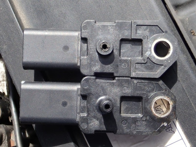

Looking at live data on Lexia one day into testing, I noticed turbo pressure 2 was reading atmospheric, which it didn't seem to when I looked before. This seems something to do with the engine being cold? At this point I should have used the Mityvac pressure mode to check pressure 2 sensor but I looked at the sensor on the front of the engine and thought it the same. If we still had access to PSA parts, I would have realised the two pressure sensors are slightly different - one for tube and one for hole with an O ring. I gently pulled the front sensor (pressure 1?) and it broke, leaving most of its stem and O ring near where the EGR pipe enters the intake. Then I realised it was no use as a substitute, finally tested both sensors with the Mityvac and they seem fine from small to large increases over atmospheric.
To remove the broken pressure 1 sensor stem I will have to remove the butterfly valve so the plastic doesn't go into the intake. To keep going, it's broken anyway, I tried some superglue on the recessed stem and restarted.

I feel a fool for breaking the front pressure sensor, but it is meant to come out and is likely trapped by aluminium corrosion. The DIY car parts market in France is years behind the UK, lucky if they even ship next day never mind have it in your hands. I have ordered the two pressure sensors and the vacuum solenoid, not because I believe they are all needed but it is so slow getting parts here. Is this anything to do with sensors, or should I be looking at EGR (at least ticks on test activate) or turbo or perhaps put some LHM into it?

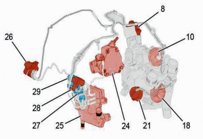

I can provide the following for you which may help with the workings of the Turbos on this engine, but as you've already mentioned, if you need any parts info that will cover you for up to 2 years, please do follow the donation link in the table below.
DW12BTED4 Engine Turbo Specifics:
Special features:
4 cylinders, 16 valves
Direct injection turbocharged by 2 parallel sequential turbochargers
4 turbocharging control electrovalves
air/air heat exchanger(cooling of the turbocharged air)
An exhaust gas recycling device (EGR)
An electric EGR electrovalve with position copy
A low pressure circuit fitted with a transfer pump incorporated in the high pressure pump
A third generation system of filtration of pollutant particles (FAP)
Fixed geometry parallel sequential dual turbocharger
he parallel sequential turbocharging system is based on the use of 2 fixed geometry turbochargers.
The dual turbocharger permits turbocharging of the engine with air:
Turbocharger 1 operates for the low engine speed phases
Turbochargers 1 and 2 operate for the high engine speed phases
T1: turbocharger 1.
T2: turbocharger 2.
(8) Turbocharger turbine isolation valve 2 (VT2).
(10) Pressure regulation valve "Waste Gate" (VT1).
(18) Turbocharger 2 (Vrec) compressor air recirculation valve.
(21) Turbocharger 2 (VC2) compressor isolation valve.

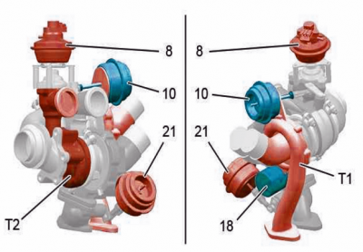

The DW12BTED4 engine turbocharging principle is based on the use of 2 fixed geometry turbochargers which can operate in single turbocharger mode or in dual turbocharger mode.
The turbocharging system is controlled by 4 pneumatic valves, which are themselves controlled by 4 solenoid valves.
(24) vacuum pump.
(25) Vacuum reservoir.
(26) Solenoid valve VT2: Device for control of the valve (VT2).
(27) Solenoid valve VT1: Device for control of the valve "Waste Gate" (VT1).
(28) Solenoid valve VC2: Device for control of the valve (VC2).
(29) Solenoid valve Vrec: Device for control of the air recirculation valve (Vrec).

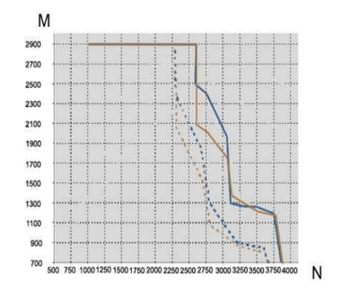

The operation of the dual turbocharger system is divided into several phases :
Single turbocharger mode with "Waste Gate" regulation (zone limited by the EGR zone)
Single turbocharger mode with VT2 regulation (transitional phase permitting the start of rotation of turbocharger 2 to limit thermal impacts and guarantee comfort during the transitions)
Dual turbocharger mode with "Waste Gate" regulation
Approximate limits of the operating zones:
c: Non-regulated single turbocharger zone.
d: Single turbocharger with "Waste Gate" regulation zone.
e: Transition or single turbocharger with VT2 regulation zone.
F: Dual turbocharger zone.
G: Torque (Nm).
H: Engine speed (rpm).
Key:0
The zone outlined in green is a compromise zone, it imposes operation in 1T mode even though the consumption would require operation in 2T mode. The operating mode chosen in this zone therefore depends on the operation of the engine (stable, acceleration, ...) and the requirement sensed by the driver.
During sharp acceleration, the transition is delayed until the forced limits corresponding to the limits of operation of the compressors.
There are two types of transition depending on the discharge of the turbocharger.
During a transition, the VT2 valve regulates the turbocharging pressure without being fully open. The transition is referred to as "normal". The transition time is between 500 ms and 1 second.
If the pre-rotation of turbocharger 2 has not begun at the time of the transition, the transition is referred to as "forced transition".
Note: The zones represented do not correspond to the operation during sharp acceleration.

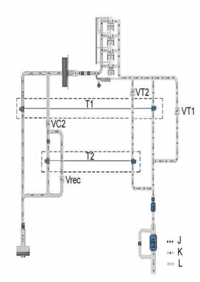

Flow chart: 1 mode - turbocharger
Note: You'll need to click the images to magnify them to see flow direction arrows
Air circulation (as per arrows):
The VT2 turbocharger isolation valve is closed permitting isolation of the turbocharger 2 turbine.
The VT1 "Waste Gate" valve regulates the exhaust gas.
Note: The diagram is only a symbolic representation of the air supply function.
Flow chart: 1T-2T transition mode or 1T mode with VT2 regulation
The VT2 valve opens gradually permitting opening of the turbocharger 2 turbine exhaust air circuit.
The VT1 "Waste Gate" valve closes gradually then again regulates the exhaust gas.
(24) vacuum pump.
- J: Exhaust gas
- K: Exhaust gas + air
- L: Air
- J Exhaust gas
- L Air
Flow chart: Dual turbocharger mode
Air circulation (as per arrows) :
- J: Exhaust gas
- L: Air
The VT2 valve is open providing the supply for the turbine of turbocharger 2.
Phases of operation
Transitions
Transitions graph.
Key
M: Engine speed(rpm).
N: Turbocharger pressure.
Solid blue line: Switch from single turbocharger to dual turbocharger mode from 0 to 1000 m.
Solid red line: Switch from single turbocharger to dual turbocharger mode at 1500 m.
Dotted blue line: Switch from dual turbocharger to single turbocharger mode from 0 to 1000 m.
Dotted red line: Switch from dual turbocharger to single turbocharger mode at 1500 m.
Depending on the engine speed and the boost pressure reference value, the engine ECU gives the order to switch to single turbocharger/dual turbocharger transition or to dual turbocharger/single turbocharger transition.
The transition switch graph differs in relation to the altitude (Atmospheric pressure).
The order to switch to dual turbocharger is also given when a system fault is recognised by the pressure sensor downstream of the turbocharger 2 compressor (Example : VC2 valve open).
The transition may be suspended in the event of sharp acceleration. The rapid increase in torque means that the transition must take place as late as possible. The transition takes place when the compressor enters the forced transition zone.
A single turbocharger/dual turbocharger transition may be requested depending on the use of the engine.
A dual turbocharger/single turbocharger transition may be requested if sharp acceleration is detected to improve the low engine speed low load performance in dual turbocharger mode.

Two and a half years late, an update for anybody searching this issue. Hopefully nobody has needed this knowledge in the interim. It is wrong that I did not return to the forum when I was offered help so quickly. I did at least contribute to the fighting fund at the time. There are two common reasons when this happens in car forums, laziness and where posters' lives have become complicated. Mine has been the latter. Apologies. My "to do" list just gets longer.
In my last post (06/08/20) I said the car was now running well. The fault codes were so mixed up, I had initially wanted to test the two pressure sensors with a Mityvac and also try reversing them. Although the two pressure sensors appear to have identical bodies, one has an O ring and goes into the metal intake body at the front centre of the engine while the other is top right (as viewed) of the engine with a pipe connection. When I tried twisting the sensor in the metal intake, it snapped. I thought I had been too rough, but I found that the aluminium intake corrodes, expands and traps the sensor end in place. It was never going to pull out, I had to drop the large diameter pipe from the intercooler so I could (carefully) drill out the sensor end that had snapped off.
The car has two variable and two on/off vacuum solenoids. One variable solenoid is accessible (front left as viewed) but the other three (front right) are trapped behind the vacuum pipework. I bought one of each type of solenoid and one of each pressure sensors. All I used was the replacement sensor that I snapped. The solution was actually very simple, I did not even need to touch that sensor.
Various Mityvac tests, pulling vacuum or just teeing in to use as a gauge, suggested things should be working. I decided to clean the remote air filters for the variable solenoids. I gave the first one a quick rinse in water and blew air gently through the end that connects to the hose. My daughter said "what's that?" and when I looked there was degraded filter foam on the outside of the filter housing. The filter had turned to dust. I had some air filter sheet used for mowers etc. so cleared the rubbish out of the housing and wrapped some sheet around with a tiewrap as a temporary fix. I then bought some nice, two part, aluminium filter housings that are designed for model car engines. This was going to be a much neater solution, but I realised that a fault on these filters can cause serious issues which make the car difficult to drive. Modification would not be a good idea insurance-wise. So I opened the filter housing, which I thought was going to be difficult but was okay with a small screwdriver, then work round with a second screwdriver like removing a tyre. I repacked with new filter material.
I speculate that degraded filter material prevents the vacuum solenoid opening quickly to atmosphere. It may seem okay on a Mityvac, but response is slowed so vacuum is maintained to the turbo for longer than expected. The variable solenoid filters have to work harder than the on/off I would imagine. This is a simple bit of maintenance. If you have a 170 engine, do change your filters before you enter limp mode on a motorway at night. I understand these separate filters also exist on C4,C5 etc where they only have one of the variable solenoids as the only solenoid.

Images,
New sensors. FAE did not come with O ring, the original was stuck in the intake and was reused
Original sensors compared
Intake sensor snapped in hole
Part numbers,
Sensor with O ring
9649396580 (Denso original)
FAE 15108 replacement
Sensor on pipe
9651931280
FAE 15107 bought, not used
Part numbers,
Sensor with O ring
Sensor on pipe
9651931280
