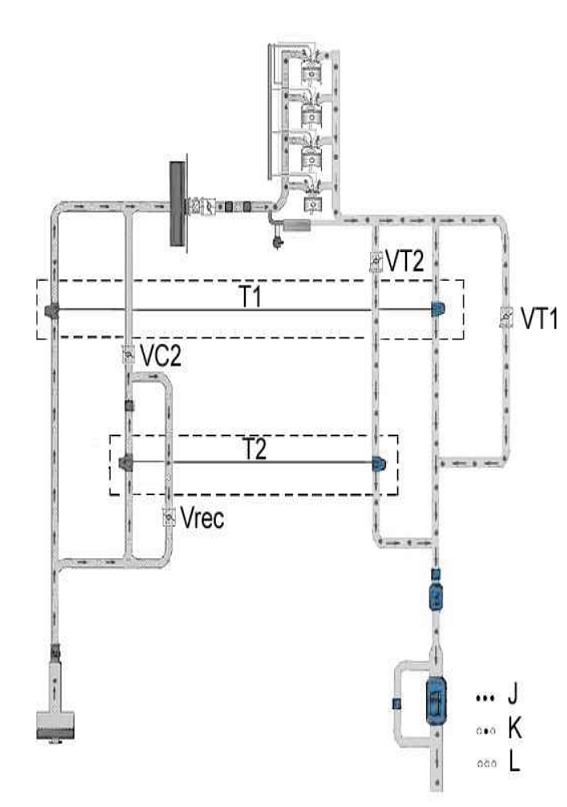

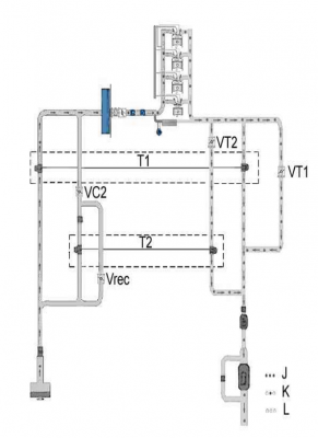

Sitting comfortably Chris: Here you go
I can provide the following for you which may help with the workings of the Turbos on this engine, but as you've already mentioned, if you need any parts info that will cover you for up to 2 years, please do follow the donation link in the table below.
DW12BTED4 Engine Turbo Specifics:
Special features:
4 cylinders, 16 valves
Direct injection turbocharged by 2 parallel sequential turbochargers
4 turbocharging control electrovalves
air/air heat exchanger(cooling of the turbocharged air)
An exhaust gas recycling device (EGR)
An electric EGR electrovalve with position copy
A low pressure circuit fitted with a transfer pump incorporated in the high pressure pump
A third generation system of filtration of pollutant particles (FAP)
Fixed geometry parallel sequential dual turbocharger
he parallel sequential turbocharging system is based on the use of 2 fixed geometry turbochargers.
The dual turbocharger permits turbocharging of the engine with air:
Turbocharger 1 operates for the low engine speed phases
Turbochargers 1 and 2 operate for the high engine speed phases
T1: turbocharger 1.
T2: turbocharger 2.
(8) Turbocharger turbine isolation valve 2 (VT2).
(10) Pressure regulation valve "Waste Gate" (VT1).
(18) Turbocharger 2 (Vrec) compressor air recirculation valve.
(21) Turbocharger 2 (VC2) compressor isolation valve.
The DW12BTED4 engine turbocharging principle is based on the use of 2 fixed geometry turbochargers which can operate in single turbocharger mode or in dual turbocharger mode.
The turbocharging system is controlled by 4 pneumatic valves, which are themselves controlled by 4 solenoid valves.
(24) vacuum pump.
(25) Vacuum reservoir.
(26) Solenoid valve VT2: Device for control of the valve (VT2).
(27) Solenoid valve VT1: Device for control of the valve "Waste Gate" (VT1).
(28) Solenoid valve VC2: Device for control of the valve (VC2).
(29) Solenoid valve Vrec: Device for control of the air recirculation valve (Vrec).
Operation of the turbocharging system
The turbocharging system is controlled by 4 valves (pneumatic actuators).
2 "All or Nothing" (TOR) valves located on the inlet air circuit of turbocharger 2 including:
"Vrec": Turbocharger 2 compressor air recirculation valve, which makes it possible to cause compressor 1 to operate outside its pumping zone when turbocharger 2 comes into operation
"VC2": Turbocharger 2 compressor isolation valve
2 "proportional" valves located on the air exhaust circuit:
"VT1": "Waste Gate" valve permitting regulation of the exhaust gas in parallel with the turbine of turbocharger 1
"VT2": Turbocharger 2 turbine isolation valve permitting the gradual start of rotation of turbocharger 2
The valves are activated by means of a vacuum.
This vacuum is provided by the solenoid valves (pneumatic control) which are controlled by the engine ECU and supplied with vacuum by the vacuum reserve.
The operation of the dual turbocharger system is divided into several phases :
Single turbocharger mode with "Waste Gate" regulation (zone limited by the EGR zone)
Single turbocharger mode with VT2 regulation (transitional phase permitting the start of rotation of turbocharger 2 to limit thermal impacts and guarantee comfort during the transitions)
Dual turbocharger mode with "Waste Gate" regulation
Approximate limits of the operating zones:
c: Non-regulated single turbocharger zone.
d: Single turbocharger with "Waste Gate" regulation zone.
e: Transition or single turbocharger with VT2 regulation zone.
F: Dual turbocharger zone.
G: Torque (Nm).
H: Engine speed (rpm).
Key:0
The zone outlined in green is a compromise zone, it imposes operation in 1T mode even though the consumption would require operation in 2T mode. The operating mode chosen in this zone therefore depends on the operation of the engine (stable, acceleration, ...) and the requirement sensed by the driver.
During sharp acceleration, the transition is delayed until the forced limits corresponding to the limits of operation of the compressors.
There are two types of transition depending on the discharge of the turbocharger.

Air circulation (as per arrows):
The VT2 turbocharger isolation valve is closed permitting isolation of the turbocharger 2 turbine.
The VT1 "Waste Gate" valve regulates the exhaust gas.
Note: The diagram is only a symbolic representation of the air supply function.
- J: Exhaust gas
- K: Exhaust gas + air
- L: Air

The VT2 valve opens gradually permitting opening of the turbocharger 2 turbine exhaust air circuit.
The VT1 "Waste Gate" valve closes gradually then again regulates the exhaust gas.

For anyone reading this later, I was wrong about the variable vacuum control that is behind the two on/off controls on the front right of the engine. It appears the same 9661960380 as the valve that sits on its own front left of the engine. The filter is dead obvious when you trace the pipework with a finger, on the left side of the oil filler and below the EGR pipe. I haven't confirmed the part number on the valve itself, just looks the same.
Edited because I was referring to the single valve on the left as waste gate control. The diagram from Marc above and a note in a French forum explain that waste gate is the hidden variable valve in the group of three. So I haven't tested vacuum on the waste gate diaphragm. The single one I checked is VT2 which spins up the second turbo. My fault said low pressure 2 so it could be that single valve, or maybe the main waste gate control tends to trigger pressure 2 even though both sides of the turbo are affected. Or the two on/off valves. Take your pick really.
The French might have more of these engines as they seem to write about them a lot. Plenty of references to changing all four vacuum valves and the car being transformed. Should have ordered more valves.

Re: Limp mode away from home C8 2.2 HDi 170 auto
Looks like fun! I imagine the small turbo spins up at idle to around 2k rpm then opens the wastegate after the big turbo takes over. That would be your atmospheric reading. They only work together for a very short period so one will almost always be spinning for nothing while the other is working. That's my take on it.
Heat and oil takes it's toll on these valves...
