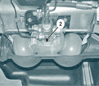

No Mike.
The system needs depressurising first all or it will be the fastest way you have travelled to the next County!
You have several options, depending on whether you have a Lexia / Diagbox diagnostic kit or not.
A) If you have such a kit, you can depressurise the whole suspension system using this method:
Switch off the ignition & Disconnect the battery. This is essential, as the suspension system is active with the ignition off and if a door is opened it will trigger the system to operate!
B) If you don't have a kit, you can manually depressurise the front or rear axles independently, depending on the spheres you are replacing.
Raise the vehicle and support on axle stands, wheels free.
You will loose fluid, so don't re-use any reclaimed LDS that comes out, so make sure you have sufficient new LDS fluid to hand.
| Depressurising the front axle | Depressurising the rear axle |
BSI Reset / Battery Disconnect / Reconnect Procedure
