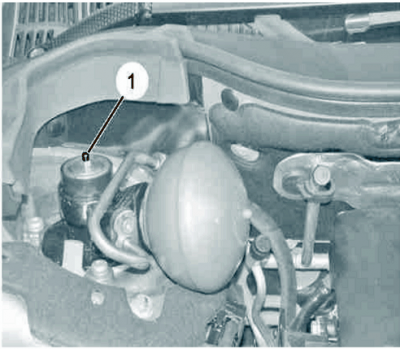

A) If you have such a kit, you can depressurise the whole suspension system using this method:
Switch off the ignition & Disconnect the battery. This is essential, as the suspension system is active with the ignition off and if a door is opened it will trigger the system to operate!
B) If you don't have a kit, you can manually depressurise the front or rear axles independently, depending on the spheres you are replacing.
- Start the engine.
- Set the height control to the "LOW" position.
- Wait for the vehicle height to be in the required position.
- Stop the engine.
- Connect diagnostic tool to the vehicle’s diagnostic socket.
- Switch on the ignition.
- Carry out an global test.
- Go into the menu:
- Suspension
- Depressurising the system
