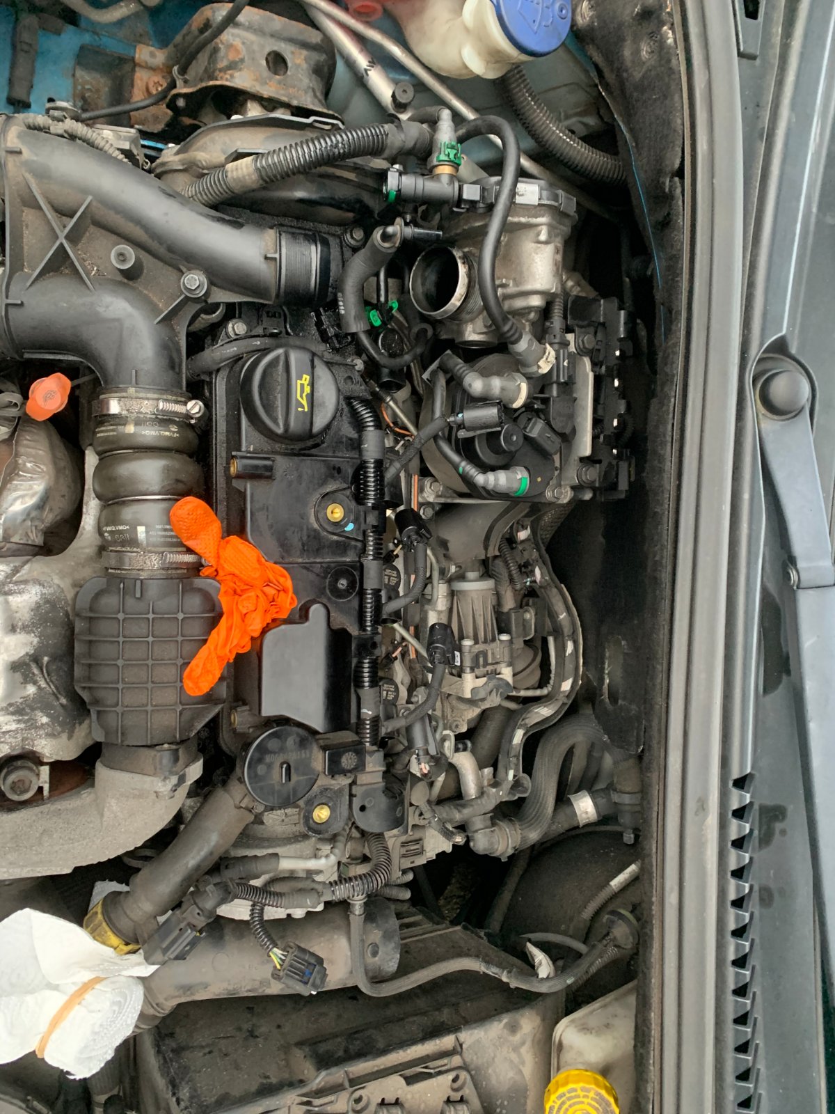

I have to replace my fuel injector on my 2011 1.6 diesel, has anyone a guide available or any tips? I've got the airbox off and it seems relatively straight forward but don't want to make a mistake!

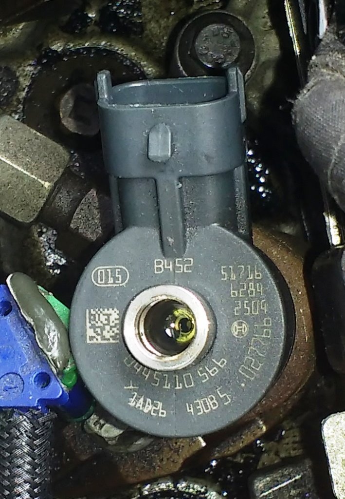

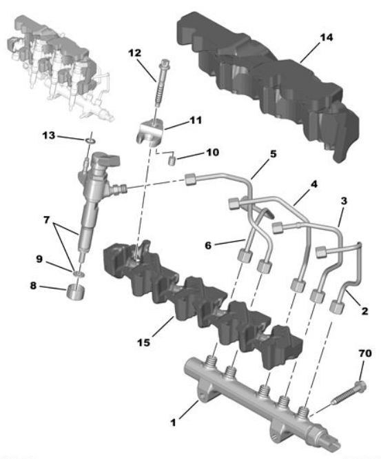

If you have a look at my thread here viewtopic.php?t=64451, probably from about half-way down the second page will be relevant. Follow the link that Marc posted for a diagram of the top of the injector.
From what I can see there's nothing specific to be aware of. The clamp bolt is a stretch bolt and should be replaced. Tightening instructions are 7nM and then +85°. You're supposed to replace the supply pipe as well but I'm going to try to reuse that to start off with.

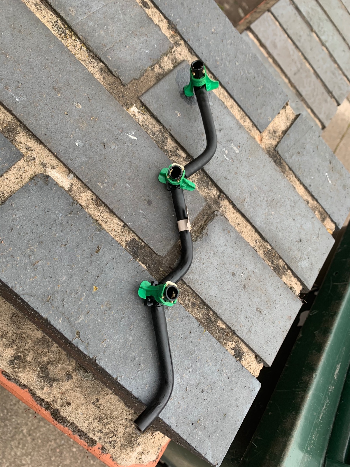

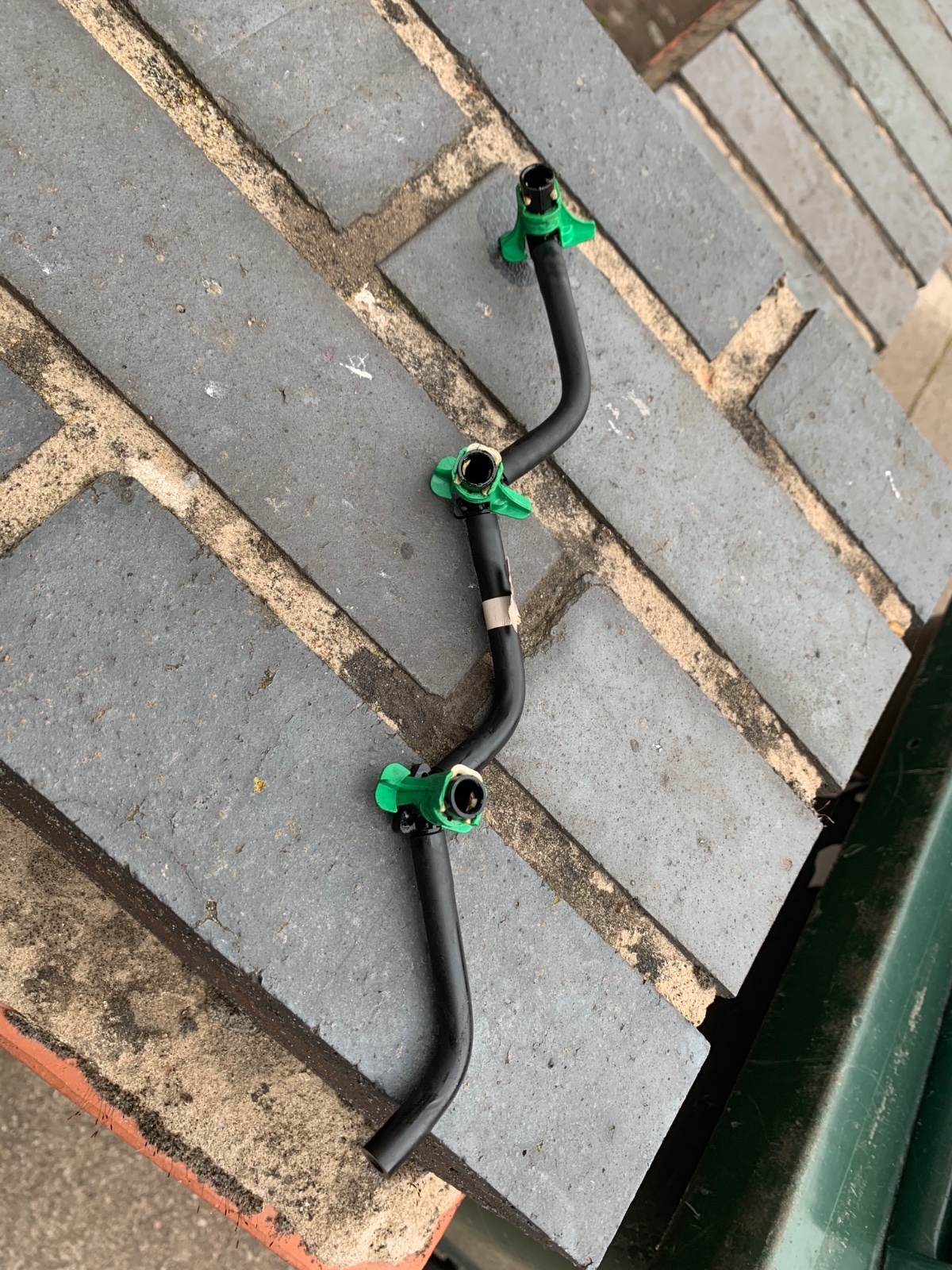

Think I need a new supply pipe anyway due to my ham fistedness.
- Posts: 9433
- x 1943
Re: Changing DS3 fuel injector
That's the leak-off hose assembly. it's not under any great pressure. How did you manage to damage it?
Also, can you post a photo of the top of the injector like I did in my post?

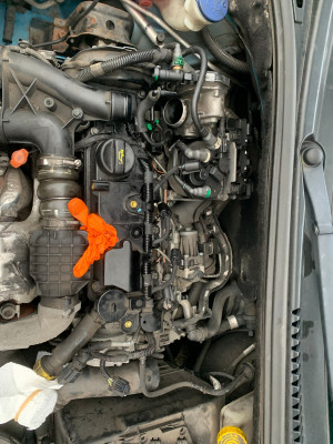

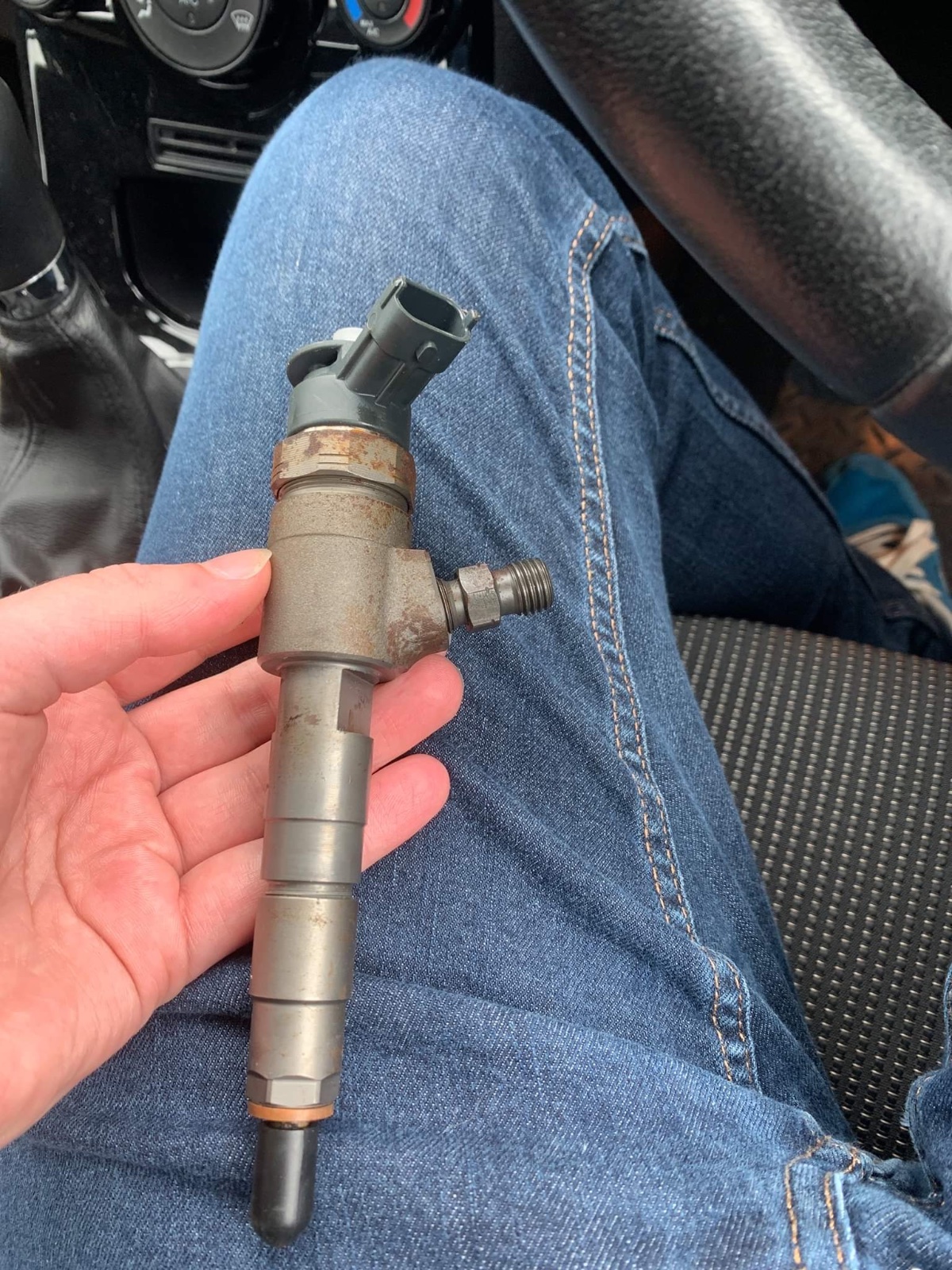

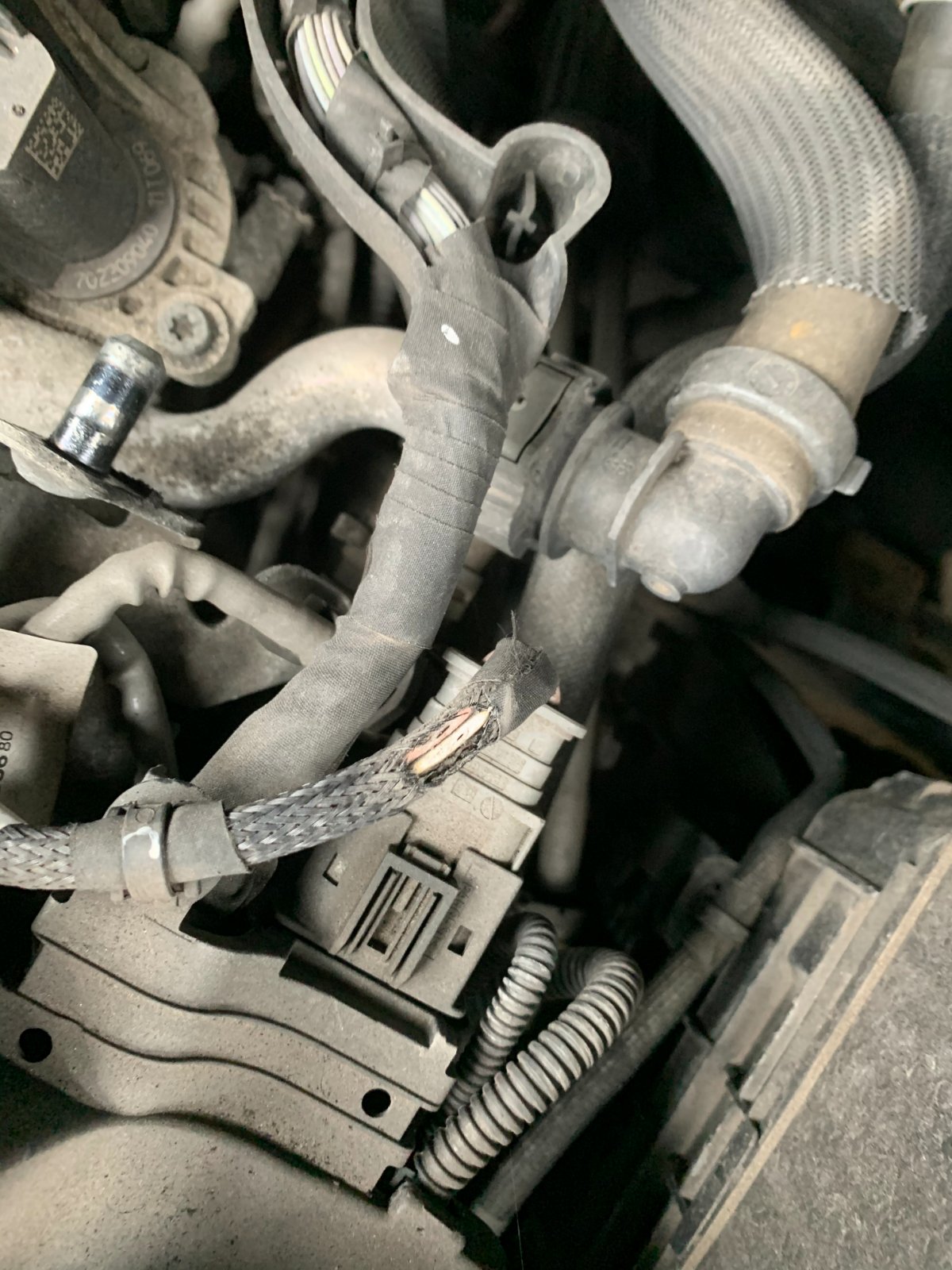

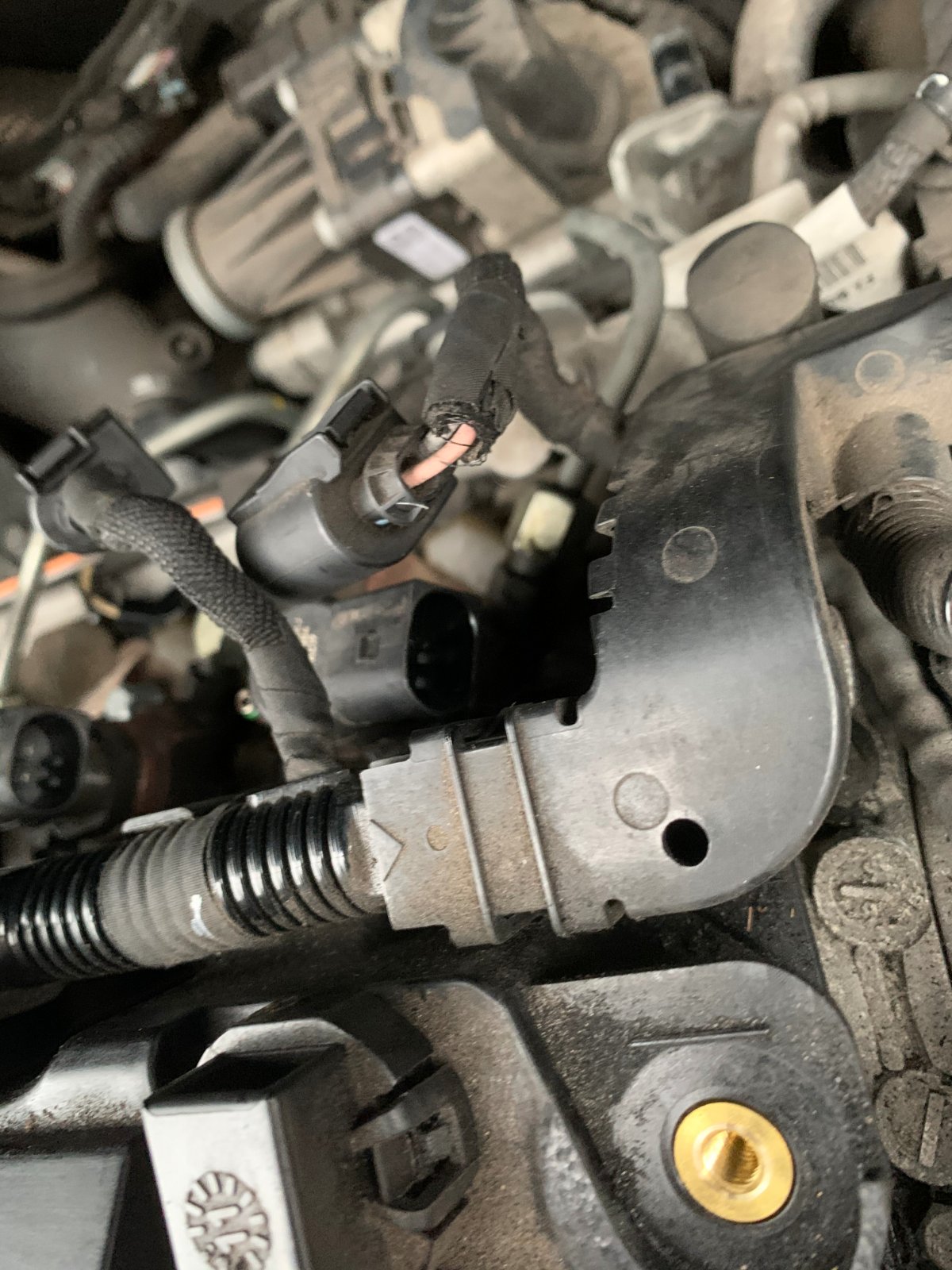

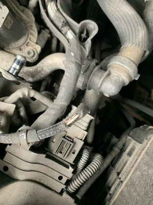

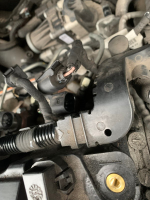

Dad took the hex off beneath the injector and snapped it
These are all the photos I have - let me know and I can provide more tomorrow

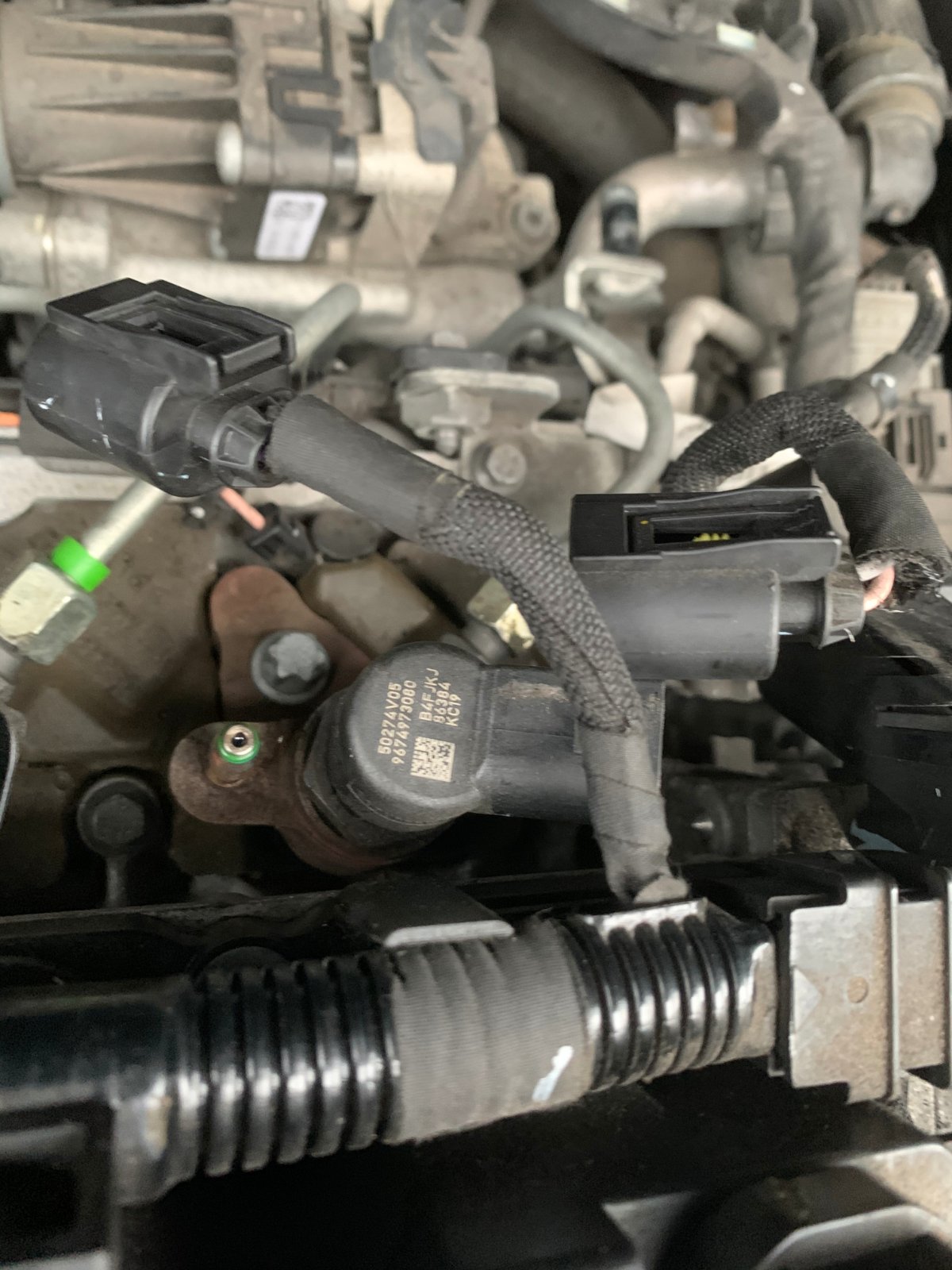

A photo of the top of the injector - assuming yours is similar to mine. Something like this one on our car.

OK, that's a Siemens injector. As seen in this Ebay offering https://www.ebay.co.uk/itm/CITROEN-PEUG ... SwZDxeOalr
I think you said you wanted the leak-off pipes but this was all I could find without a part number. I'm not about their condition though! https://www.ebay.co.uk/itm/2012-MAZDA-F ... SwQKteblQW

Thanks for that Tom.tomjyoutwit wrote: 29 Jun 2020, 18:40 Hi Marc I’ve made a donation.
Ok, so your injectors are Continental (formerly Siemens).
There was a replacement part number for the new ones: 9802448680 (£459.10 each) or the cheaper version, part number: 1608518380 (£364.68)

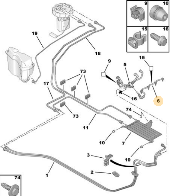

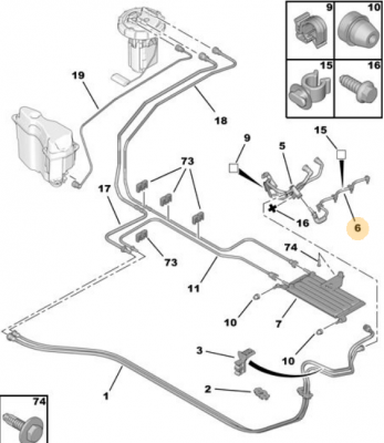

As for the Return hose:
That also has a replacement part number: 1574HX priced at £27.48.
All prices correct as of post date direct from Citroen and include VAT.
