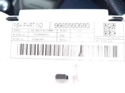

Err.... not really Steve. If I told you there were about 32 versions of these available up until July 2010 alone, you'll get the picture. Each of these are in colour or monochrome and then are different for the various engine types, Manual / Auto transmission, Stop / Start etc. etc. They changed with different build dates and to facilitate subtle changes.
If you could find the PSA part number of the one, or the VIN of the vehicle it came off, I could probably tell you if it was compatible.

Steveo
- Posts: 144
- Joined: 31 Dec 2019, 20:05
- x 13
Re: Instrument cluster
Hi Marc
Please see photograph of cluster
I unfortunately is off an automatic and I'm not sure about the engine size
Regards
Steve
Regards
