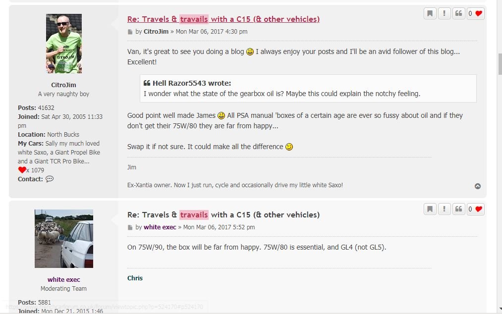

just given my 'new' box 75W 80 today, having found the attached while I was sorting out my documents.

Correct oil is 75W-80 gear oil GL-4.
The Total item is Transmission 8 Gear oil, which is the above spec. Available at any Peu/Cit parts counter as well.
Important to use GL-4, and not GL-5 (or 4/5). GL-4 contains the correct friction additives for the synchromesh to operate correctly.
