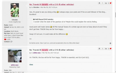

just given my 'new' box 75W 80 today, having found the attached while I was sorting out my documents.
