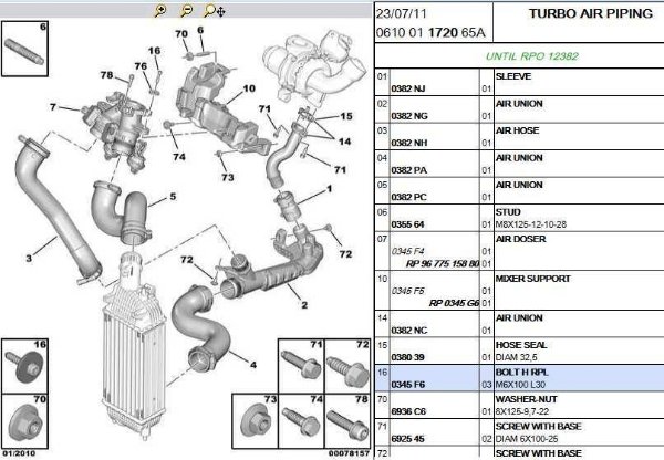

Here are the photo to illustrate the fault. The blue illustrate where the oil was finding it way out and where I found a pool of oil in the hose.
I might have the terminology incorrect.

Re: Vacuum solenoid, C5 car diesel. Correct hose locations
Bela,
Okay I know the hose you refer to, these are the turbo air hoses.
Now I believe you can get a little oil here, some of the other guys and gals will be able to confirm or not.
Kenny
Kenny
Thanks Kenny,
Hose 3 does not exists on my engine , both ends are blanked off as per original design
So if understand correctly, the turbo is pushing air from the air filter into the manifold , part 7,
So where is it getting oil from, the error codes are saying something is wrong in this system.
Maybe some one can guide me towards finding this, I'm desperate to get this engine tip top again.
If hose 3 is a bypass of the heat exchanger, then the error code P14A4, confirming the bypass is jammed shut makes me believe the system is unaware of the setup.
I'm not sure that the LIN error communication with a node of the alternator network has something to do with.
The codes are the latest from the FAPlite app .
