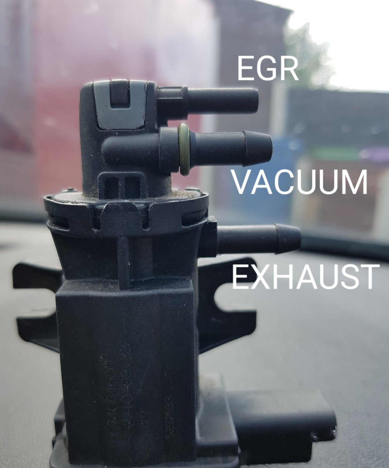

So I'm trying to find out what the physical hose connections are for the vacuum system, mainy the ERG solenoid.
The engine schematics show a 4 solenoid set up and tracing the hose is not possible. My C5 is a 3 solenoid setup
So my finding was that the ERG hose, which seems to have a green ring printed on the end was on the port which did not have the green rubber ring located, also the diameter of the hose was different than the vac hose which made it slip off easily.
So logic says the hoses were switched, but it could be the case that it did not follow the colour coding to be correct.
The pic shows the valve, and how I found it when I removed it.
I hope someone has a working engine and the right connections so I can get this solved so I can the solve the other errors I have on the car diagnostics

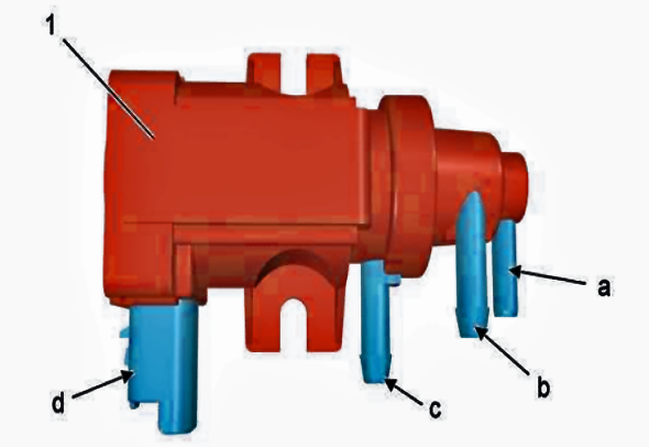

Here's the actual function:
(1) Proportional electrovalve.
"a" Vacuum inlet.
"b" Vacuum outlet.
"c" breather.
"d" 2-way black connector.
Make: BITRON/PIERBURG
The solenoid valve is a solenoid valve that is normally closed.

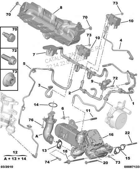

Here is the diagram from service citroen which I have saved prior to the changes
It shows the vaccum pipes and where they fit on the solenoid valves.
Kenny

Okay I know the hose you refer to, these are the turbo air hoses.
Now I believe you can get a little oil here, some of the other guys and gals will be able to confirm or not.
Kenny

Hose 3 does not exists on my engine , both ends are blanked off as per original design
So if understand correctly, the turbo is pushing air from the air filter into the manifold , part 7,

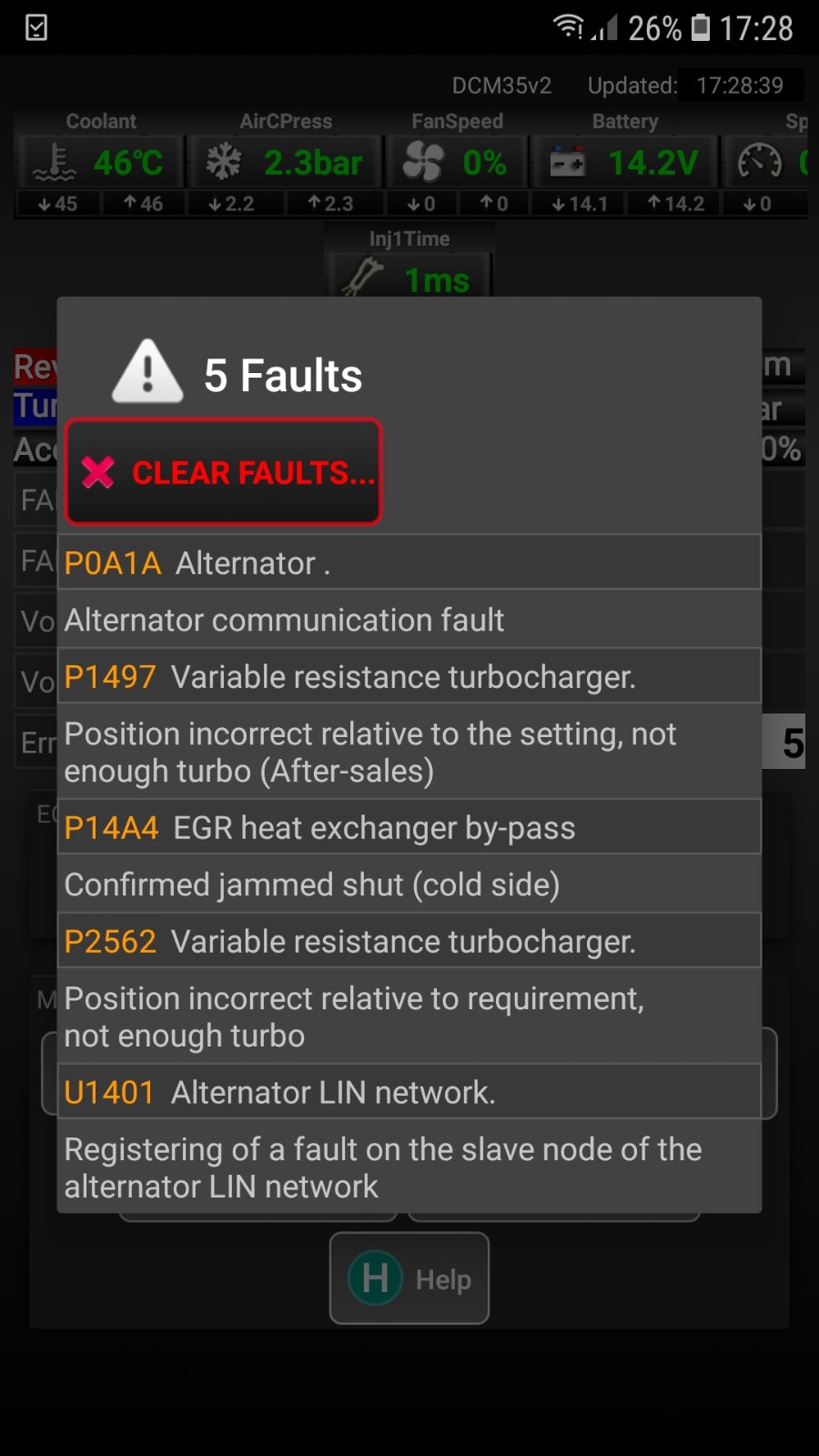

So where is it getting oil from, the error codes are saying something is wrong in this system.
Maybe some one can guide me towards finding this, I'm desperate to get this engine tip top again.
If hose 3 is a bypass of the heat exchanger, then the error code P14A4, confirming the bypass is jammed shut makes me believe the system is unaware of the setup.
I'm not sure that the LIN error communication with a node of the alternator network has something to do with.
The codes are the latest from the FAPlite app .

Here's a few more descriptors for some of those codes:
U1401: Alternator LIN network - recording the a fault on a slave node of the LIN network. Meaning there is a communication fault between ECUs detected for 3 secs.
Downgrade Modes whilst fault active:
  • Reversible deactivation of the vehicle speed limiter
  • Reversible deactivation of the vehicle cruise control
  • Reversible deactivation of the vehicle speed curbing
The battery warning light should be on with this fault on the dash.
Symptoms: Engine hesitating, cutting out, Starting problem, Lack of power
Suspect Area: Engine ECU
P0A1A: Alternator: Alternator communication fault. Alternator communication fault detected.
Again, battery warning light should be lit on dash.
Suspect Areas: Alternator, Engine ECU.
P14A4: EGR exchanger by-pass: Confirmed locked shut (R.H. side) - Closed position of the EGR exchanger by-pass switch not reached after 4 seconds even though the control is below 5 %.
Whilst the fault is active, the by-pass of the EGR gasses is in operation.
Conditions for disappearance of the fault: Driving for 5 minutes from a cold engine, until the coolant temperature reaches 80°C.
Symptoms: None obvious.
Suspect Areas:
  • EGR exchanger bypass - By-pass locked shut - Electrical harness
  • EGR exchanger bypass control solenoid valve: Failure of the solenoid valve - Electrical harness
  • EGR exchanger bypass position repeat: Electrical harness
  • Vacuum circuit
P129F: Air circuit: Quantity of fresh air above the reference value (APV). The measured air flow is greater than the reference by more than 80 mg/stroke for 8 seconds.
Symptoms:
  • Diesel fuel consumption a bit higher
  • Fluid leak / Smells
  • Engine overheating with illumination of the engine coolant temperature indicator light
  • Noise
  • Engine hesitating, cutting out
  • Lack of power
Suspect Areas: atmospheric pressure sensor
  • Air flow meter
  • Air mixer
  • Turbocharger air cooler
  • The variable geometry of the turbocharger is locked ; Turbocharger discharge insufficient
  • Turbocharger solenoid valve
  • Position indicator of the turbocharger
  • Exhaust gas recycling valve
  • Electric EGR valve position copy sensor
  • Exhaust gas recirculation line
  • Electrical harnesses
