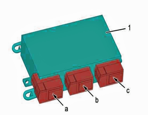

If you are referring to the optional Philips Hi-Fi system, then this is a multiplexed amplifier.Martin1980 wrote: 15 Jun 2019, 07:40 Is it possible to replace the original speakers with those of HI FI System? I have everything amp,suwoofer,speakers and wires.
It takes the 4 audio outputs and converts these into 8 amplified outputs:
- 2 front woofer outputs
- 2 outputs for the front tweeters
- 2 rear speaker outputs
- 2 outputs for the bass box
- The black connector transmits the low power information and the supplies.
- The blue connector transmits the power information to the right-hand speakers.
- The white connector transmits the power information to the left-hand speakers.

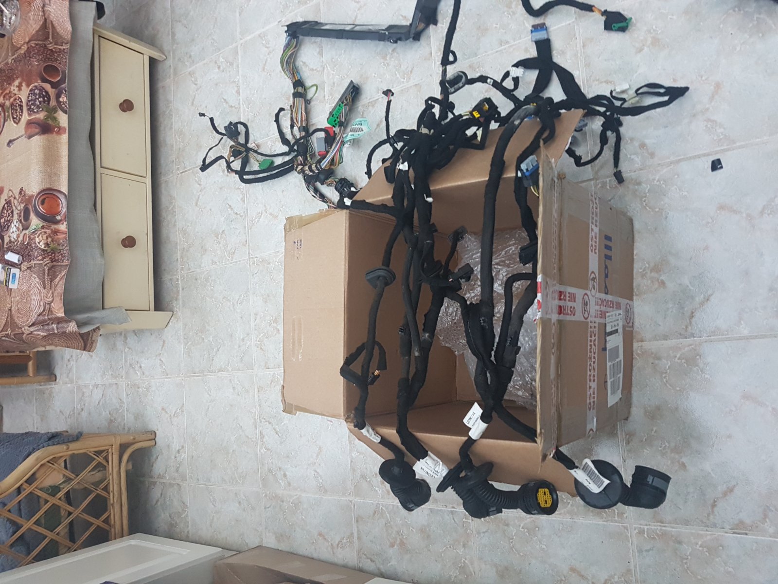

That looks like an X7 wiring loom that has been taken out of another vehicle - that's not going to be a practical option in my opinion without dismantling half the car! It's another reason why they supply repair kits for harnesses.
There are many, many different harnesses, and they are dependent on left / right hand drive, whether a telematic unit is fitted or not and what type of head unit, services module is fitted or not, engine type, equaliser option or not, etc., etc. Also, don't forget that the wiring harnesses changed depending on the build number of the vehicle too.
There are 38 different versions of the intermediate harness alone! Fitting apart, how did you determine the correct harness part number for your car with the correct options you want to fit? Cars with telematics units like the NG4 / RNEG / RT6 already have different harnesses at factory fit than a standard model with RD4 system - and then these go into different part numbers depending on the options as I mentioned above.
