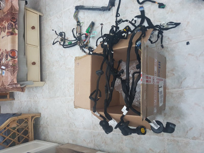

Will I have to modify my installation?I have almost all wires from the car.Were is the amplifier`s place?Could you give me the pin out connections from the 3 Equaliser 16 block connectors?

I rather suspect you're going to have to plough your own furrow here. Did the kit come with any instructions? Marc can probably tell you where the amp would sit for the standard upgrade but whether yours will physically fit is another matter. And then, because the standard upgrade integrates into the data system, you'd have to install the wiring yourself and then see if your speakers can be persuaded to fit. Or, if the speakers are too difficult to fit and the power handling capabilities are similar think about the Focal speakers providing they physically fit better of course.
Much to think about there and you may find it easier to engage the services of a professional car audio firm. Or sell it on and start again? How much did the kit cost? Have you had it fitted to another car before? Is it new?

That looks like an X7 wiring loom that has been taken out of another vehicle - that's not going to be a practical option in my opinion without dismantling half the car! It's another reason why they supply repair kits for harnesses.
There are many, many different harnesses, and they are dependent on left / right hand drive, whether a telematic unit is fitted or not and what type of head unit, services module is fitted or not, engine type, equaliser option or not, etc., etc. Also, don't forget that the wiring harnesses changed depending on the build number of the vehicle too.
There are 38 different versions of the intermediate harness alone! Fitting apart, how did you determine the correct harness part number for your car with the correct options you want to fit? Cars with telematics units like the NG4 / RNEG / RT6 already have different harnesses at factory fit than a standard model with RD4 system - and then these go into different part numbers depending on the options as I mentioned above.
