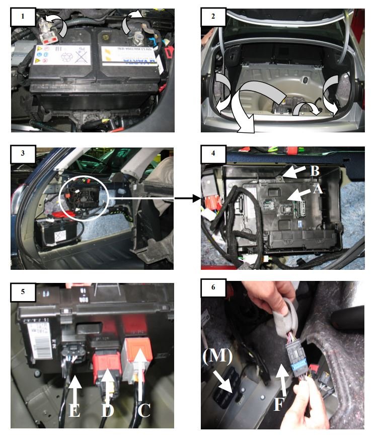

So the trailer Relay Unit (BSR EV) is part: 9688EL or may have 1610619280 on the unit.
There are 2 harnesses compatible - Part: 9428F7 which is the 13 channel towbar harness for electrical supply of a trailer for this specific vehicle.
The second one is the additional harness if you need to power a fridge: 1609732180
For the first one, I have emailed you the fitting guide for this specific harness - if the wires are not the same, then I suspect they have wired in the wrong one.....

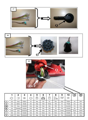

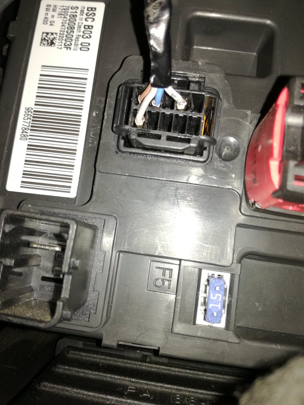

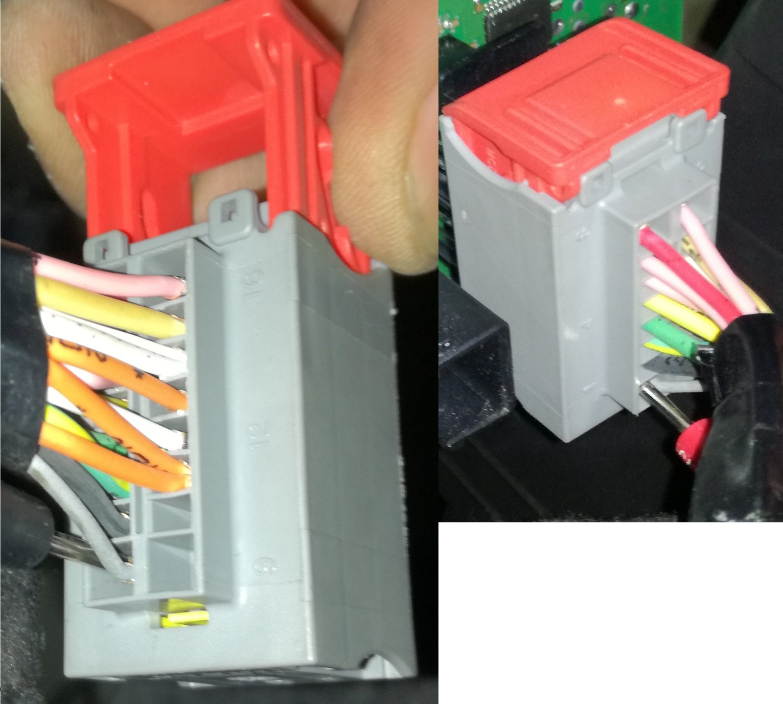

The sticker on my TRU shows 9665778480 with some additional numbers.GiveMeABreak wrote: 23 Feb 2020, 21:43 So the trailer Relay Unit (BSR EV) is part: 9688EL or may have 1610619280 on the unit.

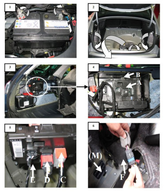

Thanks. The wiring and sockets look same as the 9428F7 in the instruction, except:GiveMeABreak wrote: 23 Feb 2020, 21:43 There are 2 harnesses compatible - Part: 9428F7 which is the 13 channel towbar harness for electrical supply of a trailer for this specific vehicle.

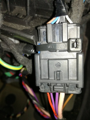

- I have no wire in pin/connector location number 3 in the socket "E" (third wire from the left in picture of the step 5)
- The socket of my car built-in harness the socket "F" connects to has 5 wires. It is missing the green wire on the picture for step 6. The picture is not very precise, but I have an impression that it is not used anyway. Can you confirm?
I believe I have seen this instruction before (or at least pictures from it) which actually led me to "the missing wire" theory
It also appears I have more wires in the 16 pin socket "C", but again, it's hard to tell from photos. I have identified the BSI connecting socket and pin locations the socket F harness goes to for all but one wire. It is actually one of the trailer presence contactor circuit wires , the one that connects to pin number 4 in the socket "E".

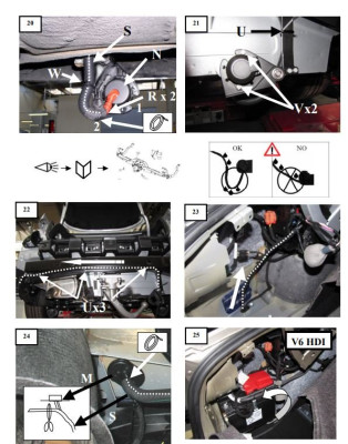

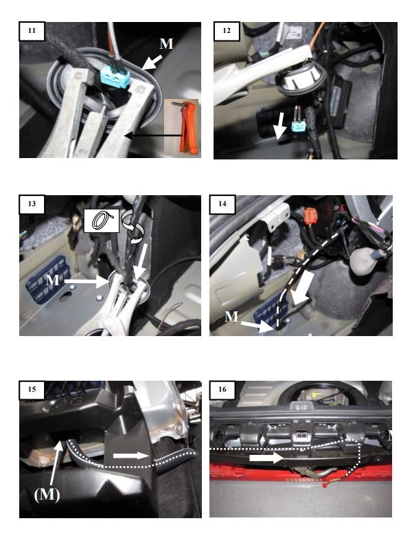

Ok, so the original PSA part number for the 13 Channel towbar harness compatible for your X7 is part: 9428 F7, costing £169.75 inc. UK VAT from Citroen today. This would of come with the trailer relay unit included in the kit.
The correct relay fuse box (BSR EV) on its own (shown as 'A' in the above photo) for your multiplexed X7 alone is part number: 9688EL, costing £158.88 including UK VAT as of today. Note these do not support trailers or caravans with LED lights.
Here's the instructions in case you don't have them:
Click Images to Zoom
So 9688EL is the part you need for just the fuse box if looking for a second hand one or one from an online seller. If you Google this part number, as long as they quote this part in the description it should be fine as this is the correct one for your X7. Some other X7 vehicles with different engines have a different part.
viewtopic.php?t=69962
