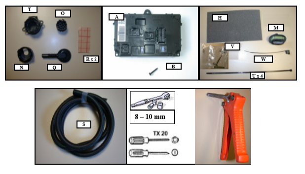

Description: "13 channel towbar harness for electrical supply of a trailer"
Tech Characteristics: One 13-way socket and its fixings, One BSR (Towing Relay Unit) and its support.
Features / Statements:
- This harness is particularly suitable for providing the lighting supply to trailers or cycle-carriers on tow bars.
- This harness has been developed to incorporate all of the vehicle special features.
- It also provides an electrical supply to the fog lights and reversing lights.
- Comes with a 13-way socket to correspond to the trailer socket.
- It incorporates all the features needed for good compatibility with this vehicle and is SAFE, RELIABLE and EASY to fit.
- The functionality of the harness will be obtained by configuration of the BSI (fitting by the network is imperative).
9427 CV : SWAN’S NECK TOWING BALL
9427 CW : MANUAL RETRACTABLE TOW BAR
9427 CX : SWAN’S NECK TOWING BALL
9427 CY : MANUAL RETRACTABLE TOW BAR
9427 CZ : TOW BAR WITH TOW BALL THAT CAN BE REMOVED WITHOUT TOOLS
9427 EA : TOW BAR WITH TOW BALL THAT CAN BE REMOVED WITHOUT TOOLS
16070425 80 : (ACC) TOWBAR ELECTRICAL SOCKET

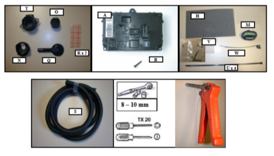

I've emailed the fitting instructions for this particular kit Paul, but here are a couple of shots from them of the specific kit:

Cheers Marc, that's excellent. I did look through the PMs but I didn't think to look at or for any photos.
I'll compare the instructions with those I've got for the Westfalia towbar and see if can understand the whole. I can see that I'm going to have to fit a damn 13-pin socket rather than a 7-pin socket which does not please me. Extra expense for an adaptor loom.
