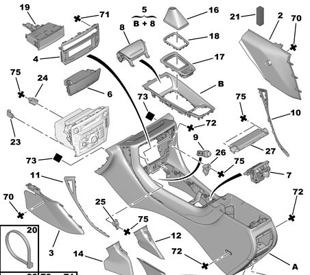

I did drive about 20km after reset. It´s not even possible to synchronise with GPS, it´s grayed out (and it wasn´t checked earlier).
I guess it´s the Joying way then... BTW, what is the part number for that "empty box" that is installed in the place of radio with SMEG? I tried to look at it in the service.citroen, but couldn´t find.

Re: No Satellites Issue
There's a combination of different side fascia plug modules (volume + / -) etc that replace the ones that are there in the central console and a combination of cubby hole and push to open / close storage.
it´s 98120802ZD I guess.
