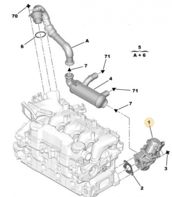

This is the location on your engine, item (1):
I'll put a guide up shortly.

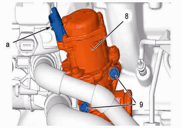

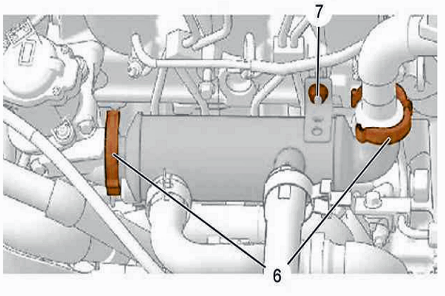

Remove:
- The upper integrated air intake system
- The fuel filter (/)
- The fuel filter support
Remove:
Remove: The air filter housing support . | Disconnect the connector ( as "a"). Remove:
Note: At refitting, all the removed seals must be replaced with new seals. Use clips with screws (Specific to Service). Ensure that there are no foreign bodies in the intake circuit.
Check: The union of the turbocharger air inlet .
Always replace:
- The metal seal
- The clic clips (6)
- The exhaust gas recirculation solenoid valve (8)
- The 2 bolts (9), tighten to 1 ± 0,1 daN.m
Refit:
- The air filter housing support
- The exhaust gas recycling heat exchanger
- The clic clips (6) (new)
- The fixing (7)
- The fuel filter support, tighten to 0,8 ± 0,1 daN.m
Refit the engine style cover.
