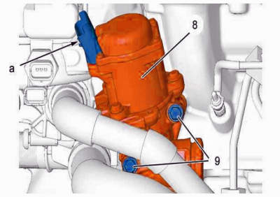

This is the location on your engine, item (1):
I'll put a guide up shortly.

Remove:
  • The fixing (7)
  • The clic clips (6), using circlip pliers
Release: The exhaust gas recycling heat exchanger (Without opening the cooling system) .
Remove: The air filter housing support .
Disconnect the connector ( as "a").
Remove:
  • The 2 bolts (9)
  • The exhaust gas recirculation solenoid valve (8)
Refitting
Note: At refitting, all the removed seals must be replaced with new seals. Use clips with screws (Specific to Service). Ensure that there are no foreign bodies in the intake circuit.
Check: The union of the turbocharger air inlet .
Always replace:
  • The metal seal
Refit:
  • The 2 bolts (9), tighten to 1 ± 0,1 daN.m
Reconnect the connector (at "a").
Refit:
  • The air filter housing support
  • The exhaust gas recycling heat exchanger
  • The clic clips (6) (new)
  • The fixing (7)
Refit:
  • The fuel filter support, tighten to 0,8 ± 0,1 daN.m
  • The fuel filter (/)
  • The upper integrated air intake system
Reconnect the battery. (follow relevant section of procedure linked to above)
Refit the engine style cover.
