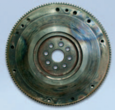

Frenchy
Posts: 33
Joined: 13 Aug 2016, 12:57
x 23
Re: clutch 2.1 dual mass flywheel
Unread post by Frenchy »
Wow. Thanks for the info. Saw my son today and he has clarified that the clutch isnt juddering.
The 2.1 TD has the dual mass flywheel. I was informed that the 2000 HDI 2.0 that we had did not have the dual mass flywheel so therefore would not fit the 2.1.
I shall get the vin number tomorrow when I phone him.

Frenchy
Posts: 33
x 23
At last I have the vin number for the xantia.
I hope this will identify the car and clutch type. This has been a massive undertaking, trying to get my son to remember to send it to me.
x 6955
The clutch plate is a LUK 235 Diameter, was part number 2055AV, it has been replaced with 2052 V3
The clutch mechanism itself is 2004T5 230 Diameter, replaced with 2052V9
...and no DMF, just a solid flywheel, 0532G2
