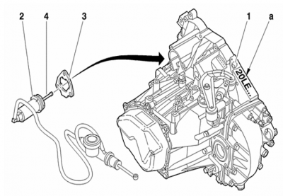

This is the mod:
Applicable to ML5T and BVM5 boxes since build date: 6951 (20/11/1995)
Vehicle application:
XANTIA Turbo CT
XANTIA 2.1 Turbo D
The mounting for the slave cylinder is built into the gearbox.
(1) Gearbox.
(2) Slave cylinder.
(3) Support.
(4) Piston rod.
(a) Location of the gearbox identification number.
Part removed: Slave cylinder mounting (3).
Modified parts:
Gearbox: The slave cylinder (2) fixing boss is thicker by 19 mm
Clutch control: The slave cylinder(4) push rod (2) is 12 mm longer (107 mm, instead of 95 mm)
Gearbox reference
VehicleNewOld
XANTIA Turbo CT20 LE 1520 LE 06
XANTIA 2.1 Turbo D20 LE 1420 LE 00
Clutch Control
The length of the push rod distinguishes the new slave cylinders from the old ones: (107 mm, instead of 95 mm).
Clutch Control
The old slave cylinder is no longer available from the Replacement Parts Division.
The new slave cylinder, together with 2 push rods, is available from the Replacement Parts Division.
Replacing an old slave cylinder with a new one:
  • Fit the slave cylinder with the long push rod to the vehicle
  • Press the clutch pedal to break the pins holding the push rod
  • Remove the slave cylinder
  • Replace the long push rod with the short push rod
  • Refit the slave cylinder
Gearbox
Only the new parts will be available from the Replacement Parts Division once stocks have been exhausted.
The long push rod ( 107 mm) is available from the Replacement Parts Division.
Replacing an old gearbox with a new gearbox:
  • Remove the slave cylinder mounting
  • Fit the slave cylinder with a long push rod ( 107 mm)

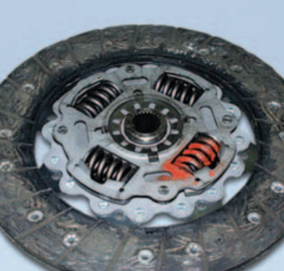

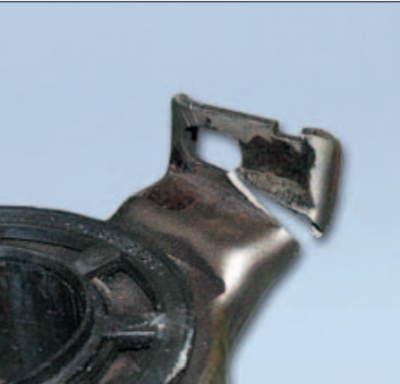

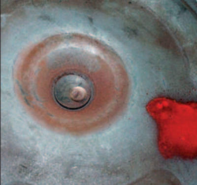

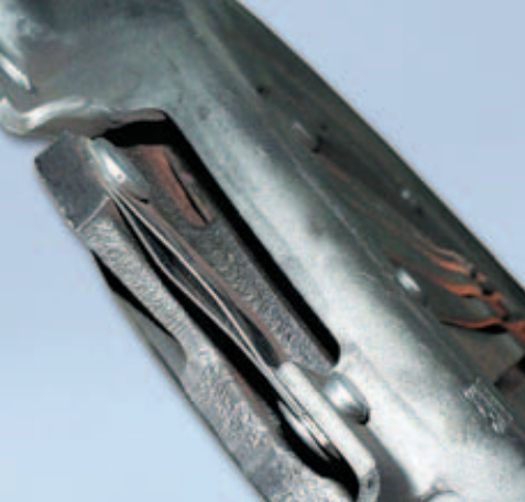

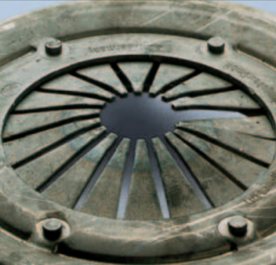

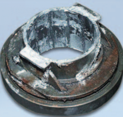

Going back to the judder, these can be some of the causes - as defined by LUK clutches (note this is generic info and not specific to PSA vehicles), but may be useful nonetheless:
Possible Causes of Clutch Judder
Incorrect grease on splines:
  • Grease containing solids has been used
Tangential strap bent:
  • Incorrect driven practice
    -> Tow starting in 1st or 2nd gear
  • Incorrect storage
    -> Dropping the clutch prior to fitting
  • Clutch not bolted up evenly and sequentially
Diaphragm spring fingers bent:
  • Incorrect fitting
    -> Diaphragm fingers bent during fitting
Facing contaminated with grease:
  • Surplus grease not removed
    -> Grease has been thrown out on to the facing material

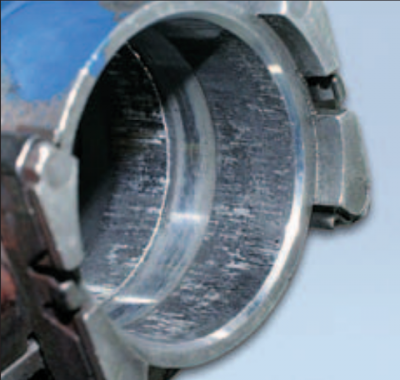

Wear marks on release bearing inner bore:
  • Incorrect grade of grease or no grease used
  • Damaged or worn gearbox snout
Facing worn on flywheel side:
  • Flywheel not replaced
  • Contact surface on the flywheel not re-machined

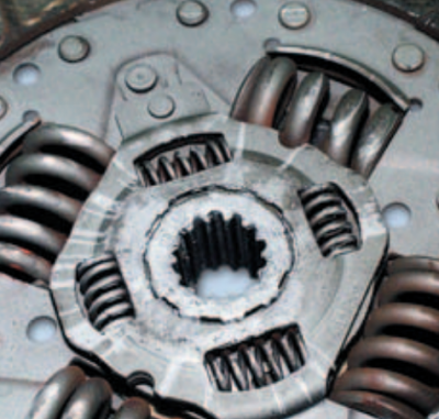

Damaged hub splines:
  • Incorrect fitting
    -> Gearbox input shaft and hub splines not correctly aligned
    prior to fitting
    -> Driven plate not centered
  • Incorrect driven plate
Release bearing worn:
  • Release fork worn
  • Release system damaged
Release bearing incorrectly lubricated:
  • Use of a solids based lubricant
Worn gearbox snout:
  • Release bearing worn
Push rod wear mark off centre:
  • Damaged release system
    -> Bearing worn
    -> Guide bush worn
Flywheel scored:
  • Flywheel not re-machined/renewed

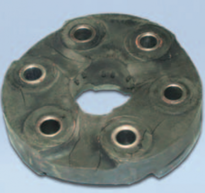

Tangential strap damaged:
  • Excessive free play in the drive joints
Damaged bearing lugs:
Facing contaminated on the inner
portion:
  • Damaged oil seal
  • Excessive grease used on the splines

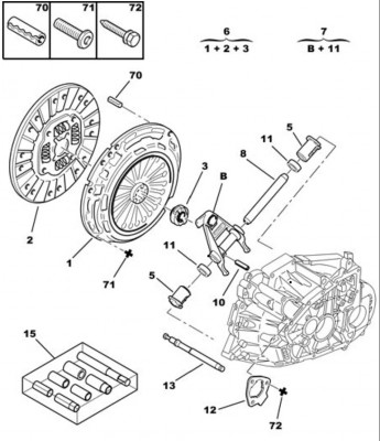

The clutch plate is a LUK 235 Diameter, was part number 2055AV, it has been replaced with 2052 V3
The clutch mechanism itself is 2004T5 230 Diameter, replaced with 2052V9
...and no DMF, just a solid flywheel, 0532G2
