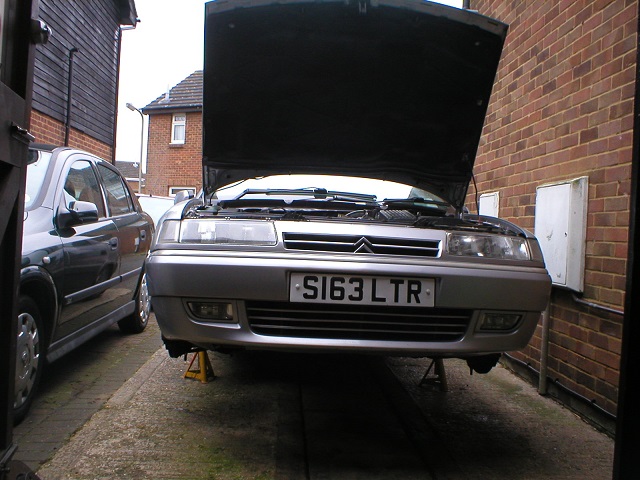

Since arriving yesterday aboard an AA recovery lorry, some good progress some good progress has been made :D
The Hub nuts have been loosened and thank goodness for S1 Activa wheels having removable centres! Due to the non-operative handbrake I had to pop the wheel centres out and undo the hub nuts with the wheels on the ground.
The lower swivel joints have been separated, the gearbox drained, the RH driveshaft intermediate bearing released from its housing and remarkably it went with ease which is unusual as often they put up a heck of a fight 8-)
Just to balance how easily the RH driveshat came apart, the LH one is playing up. It's stuck in the hub and is currently getting a feed of Plus Gas. If it doesn't soon shift with my club hammer I may have to invest in a bigger hammer!!!
The weather is rapidly deteriorating and I may not get much more done today but it's a good start!
This was the scene a few minutes ago:

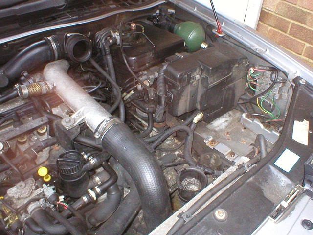

A little more progress made before the weather intervened...
Aiebox and battery tray off. LHM reservoir and ABS block next...

Hope that axle stand is not under the iffy bit of the sill!

The bits of sill the stands are on is perfectly good Davie!
